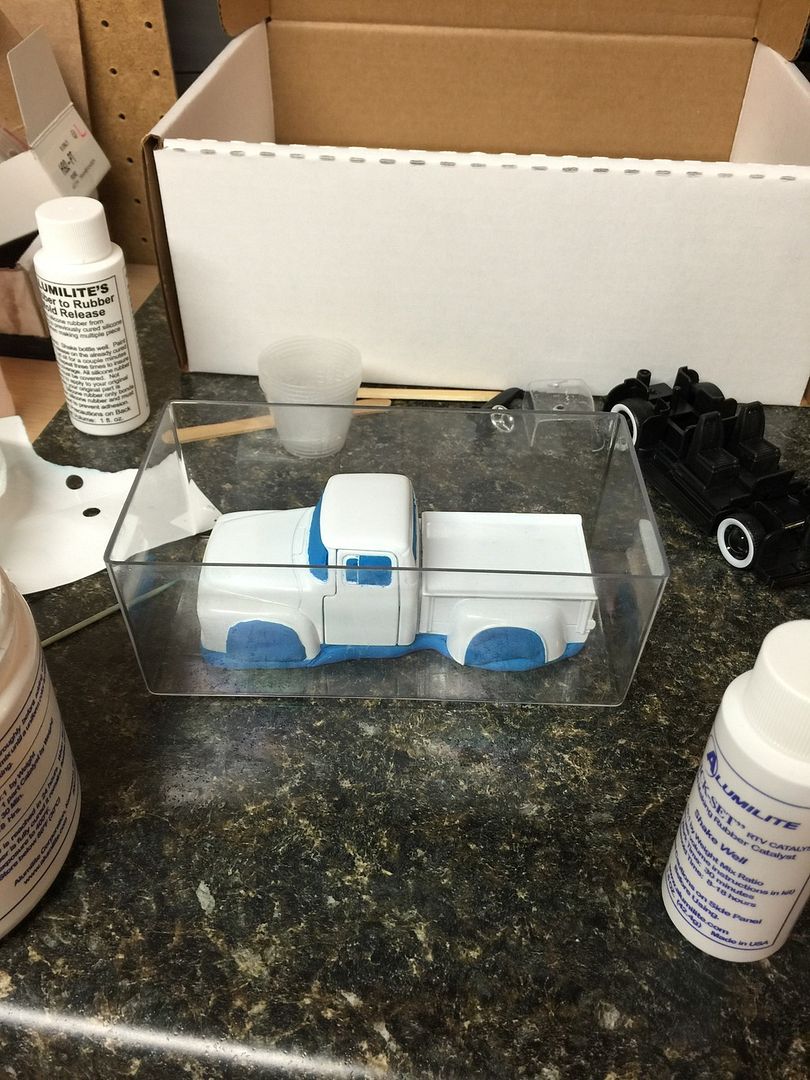

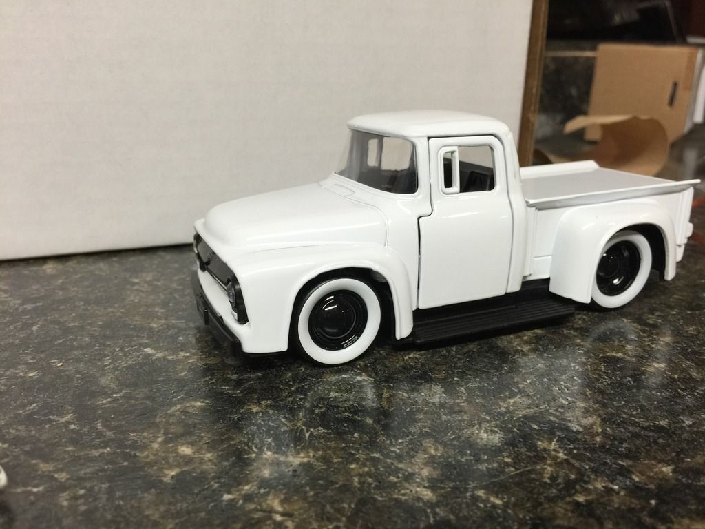

Well i jumped in! Im casting my own stuff. First up my all time favorite vehicle ever!!
A 1956 ford f100

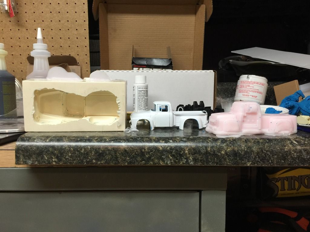

Since it looks like your using clay,undercut your openings with a small screwdriver or clay tool ...wheels wells, windows. Also at the bottom body line, this will leave you a nice clean edge to trim to when removed from the mold.

Another tip, allow at least 1/2 to 1 inch of clay below the body. Your inner plug will force resin out of the mold if you don't have that 1/2 inch or so of space above the cavity. After you cast a few, you may find a couple places that the resin doesn't easily flow to and there will be air pockets. Your best bet then is to cut some vents to allow the resin to more easily move into those parts of the mold. Two coats of silicone to silicone mold release before you do the inner plug, allow to dry at least 12 hours. Coat the whole outer mold, even where the body sets.
When you pour, rotate your mold so the resin covers the whole inside, then slowly push the inner plug in position.
If you want to skip the mold release inside your mold, a generous coating of talcum powder will work. Liberally coat the inside them blow out the excess. I will release easy and will leave a surface that is great for paint adhesion.
Plenty of guys on here that can help you along the way.

Which Alumilite are using? Their fast cure makes a nice outer mold while the slow cure makes a really flexible inner that can be removed without tearing it up. that stuff is hard to tear and so soft that you can squeeze it together easy to reove it from inside a body.

I would also fill the door shut lines and then re-scribe them....or the silicone will get in there and hold your body then rip or tear where you don't want it to.

Guys are right about silicone leaking everywhere, but with a sharp Xacto, you can trim your mold to get rid of anything that shouldn't be there. The Alumilite high strength is really great for the inner mold. It is so flexible that it will come out of your body easy and not tear if you stretch or pull it a lot.

Well mold number one is complete! Yahoo!!!! I did it lol. Now im waiting for my resin release to show up in the mail and ill be casting this bad boy!!!
