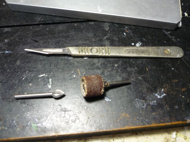

I'm with you ecr. I have been grinding a body and something catches and whips the burr around to the outside grinding a chunk out of the wheel arch or rocker panel.
Here are the tools I mostly use for the 95% trim out. The pictures were taken a few years back and the only thing that has changed is that I almost never use the sanding drum.
Those dremel burrs are good. I have a couple of other shapes I use sometimes but these two are the main ones.
I poke the vacuum cleaner nozzle through the bench vice, swing the light around and go for it...sometimes I wear ear muffs and face mask as it is noisy and messy.
