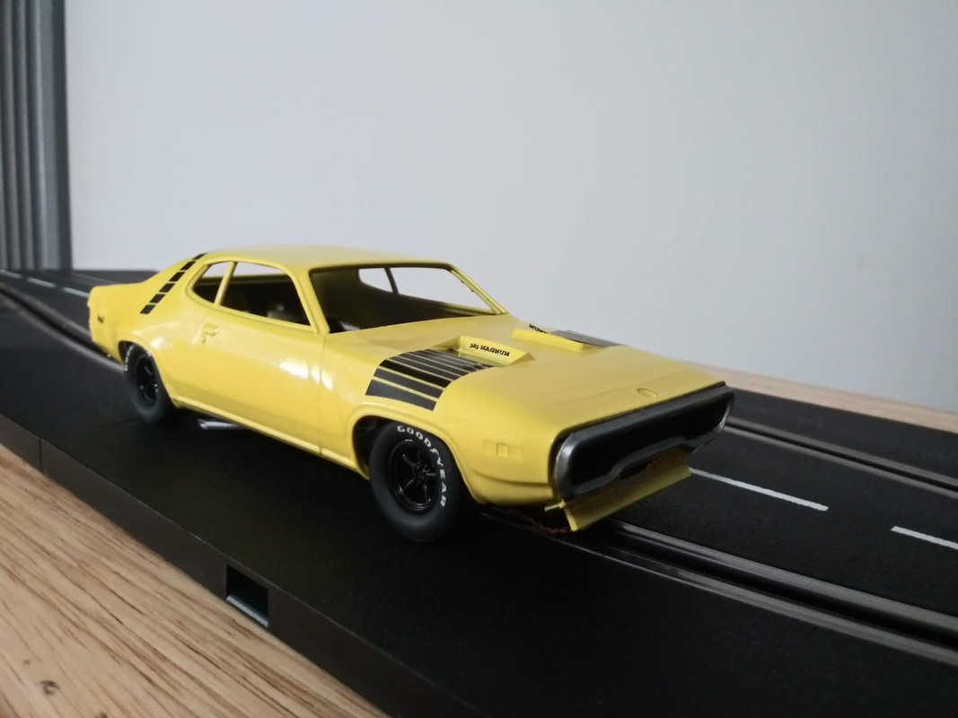

I have been very busy the past few weeks and not really able to make much progress. I painted the prototype and am messing around with decal sizes.
It sets nice on the Pioneer chassis.
I have one more mold to make for a client and then this goes on the mill. Maybe a week or 2.
A couple of things that are going to be changed. The mounting posts will not be integrated in the back. This will create a sinkhole and it would be easier to just glue in a post assembly. The windshield will be 2 parts, front and rear. It is hard enough getting one piece to fit, but then trying to get both to fit while they are attached is even more of a problem.
The front and rear of the car are going to be completely separate for race versions. So there will be a race front and race rear. This will allow for the covers that go over the lights and the spoiler to be integrated. For the street version there will be openings for lights.
This might mean only 2 hoods will fit. The plan was to make the Road Runner hood, air grabber, and flat hood. If one has to be dropped I guess it will be the air grabber and a small bump can be included to glue on top of the flat hood.
I will share some renders when I get things laid out.

Oh man! That is looking GOOD!!!! :D

Yessir! :banana-dance:

Yep, another one of those times I looked for the 'like' button.

This is looking Great! Can't wait to get some of these.
With different race front and race rear, then I think these will also look good with '72 race paint schemes.
'72 rear bumper and tail lights are different but with the lights covered it will not be as noticeable.
Great work!
