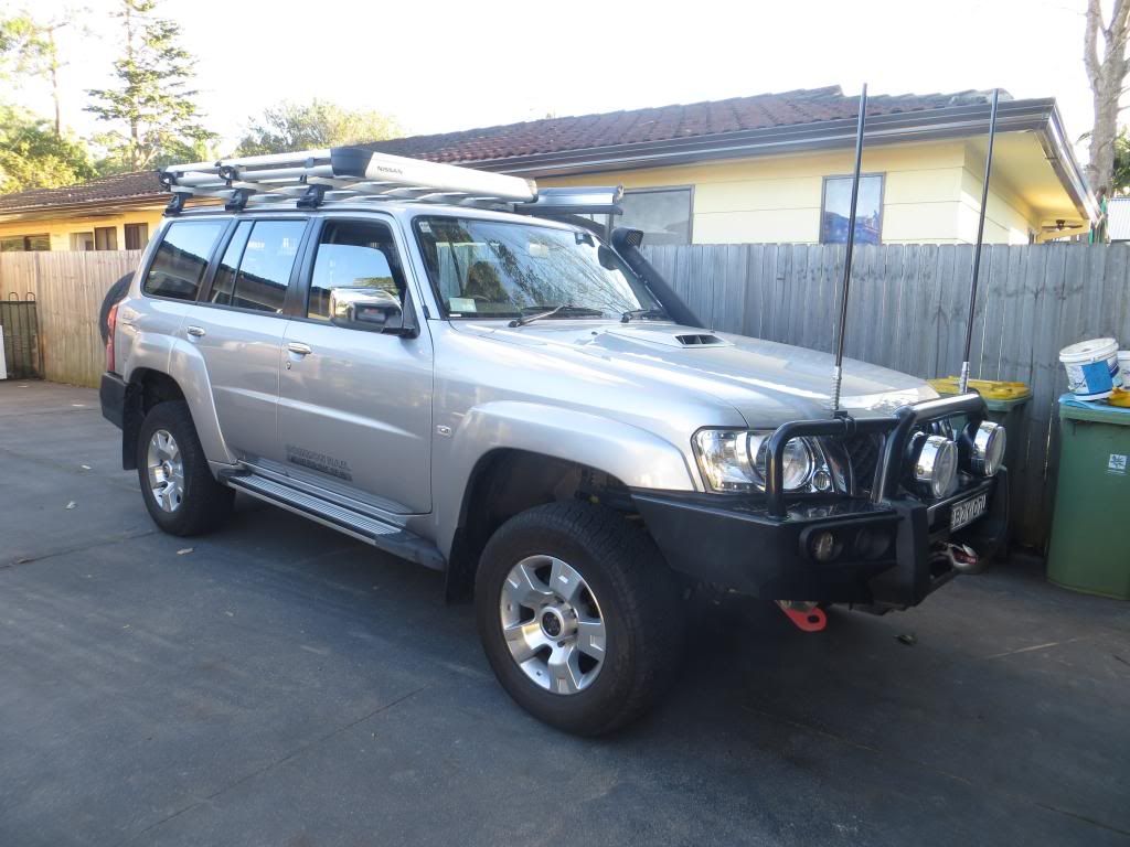

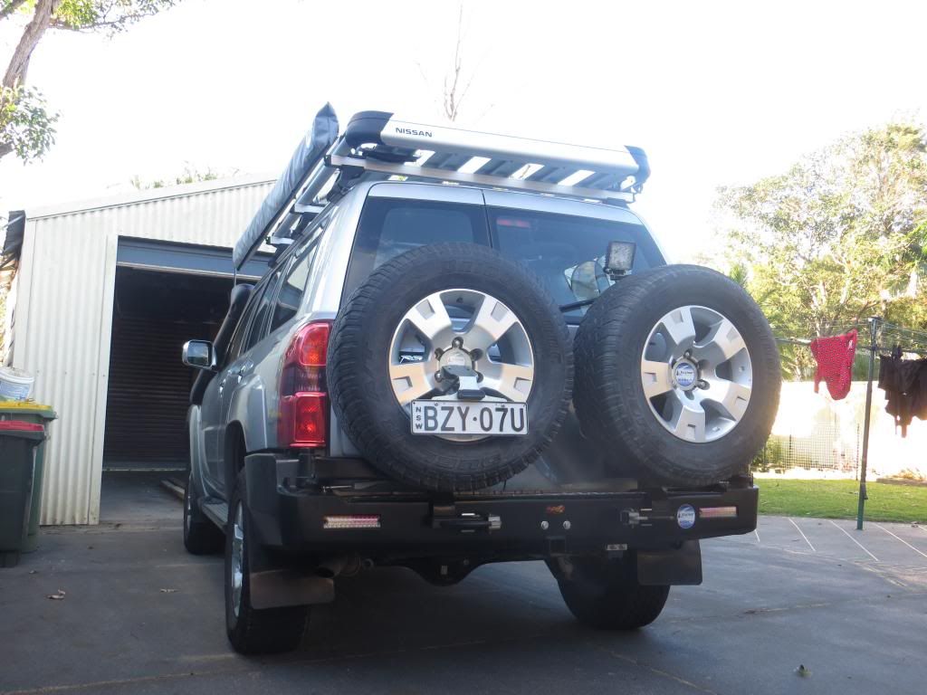

So when we go away we dont tow any caravan or trailer. Everything is carried on vehicle. On the roof we have a aluminium rack, we chose aluminium to keep the weight down. Up there we carry our tent, sleeping bags, mattresses, camp chairs & table. All that is carried in a waterproof canvas bag that zips up. Also the rack houses a gas bottle if we choose to bring it, shovel & a roll out 2.5metre awning for some shade. We have upgraded the suspension with a 2" lift & some heavy duty shocks. Also beefed up the drag link & a few other things.

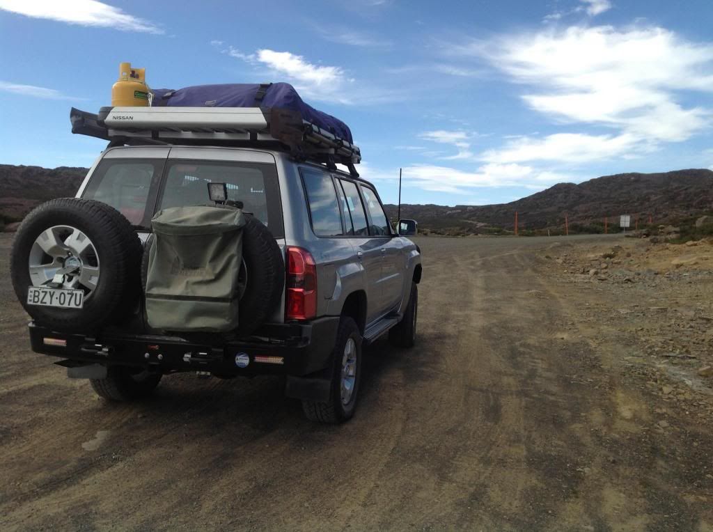

Up the rear of the truck we have a steel rear bar with twin swingout carriers. We can either house 2 spare wheels on the back or a wheel & 2 jerrycans. Also added a rear led light.

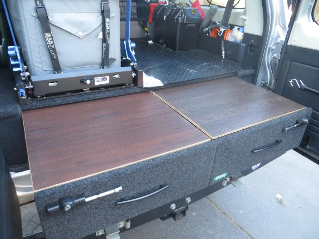

inside the rear we have a twin drawer system. These are made out of aluminium with plywood on top, this setup is ultra strong & light. I looked at making the drawers myself but after I priced it up with quality drawer runners etc it wasn't much more to buy this setup as it was priced right. I liked how light yet strong this setup is.

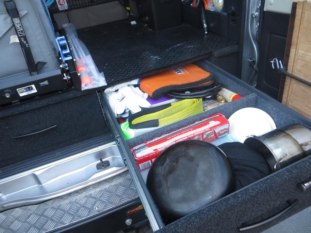

On top of the drawer setup we have a fridge & a 2nd battery. The 2nd battery is 130AH & is charged via a DC to DC charger so while Im driving it charges up. This system is great, I tried a different system prior to this & always had a flat battery. The 2nd battery powers the fridge, camp lights, air compressor, kids dvd player, charge batteries(phones, lights, iPad, camera etc). If Im in the one place for a long time I have a roll out solar panel to charge the battery. So inside the drawers, 1 drawer we fill with food. The other drawer we keep our cooking pot, pans, plates, cutlery etc & also all our recovery gear incase we get stuck we can self recover ourselves. This pic is inside one of the drawers. We leave this drawer full all the time. So we are set to go anytime.
When cooking we put some wood ontop of the drawers & this becomes our cooking surface.

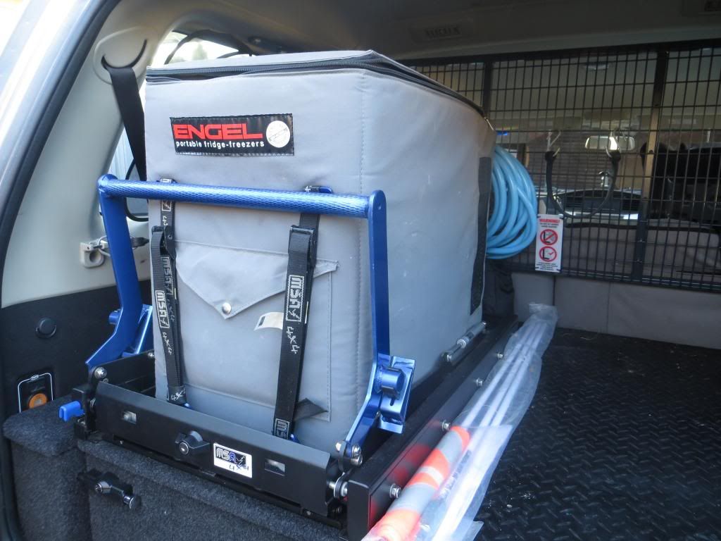

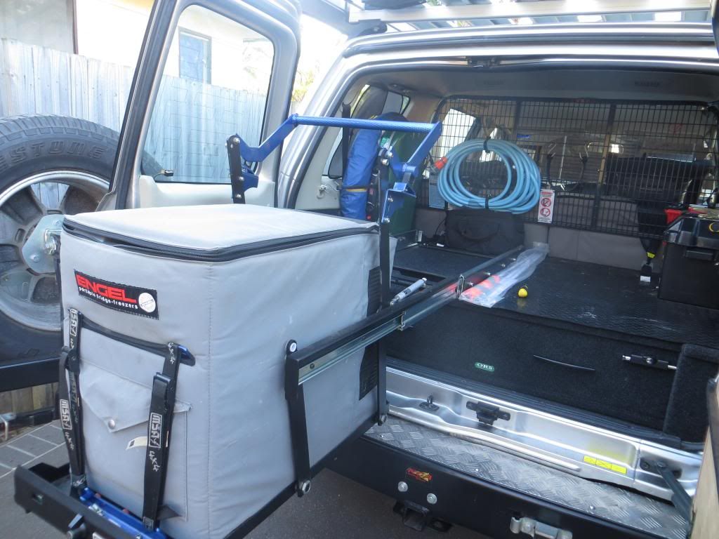

So onto the fridge, we needed a slide to slide the fridge out. You cant open the fridge as it hits the roof of the car. Problem was as the cars so high & the top of the fridge is even higher, you needed a step ladder to see inside it. After much deliberation we went with a drop slide. My wife really wanted it. It was only an extra $150 for the drop slide. I was worried about the extra weight. Its freakin heavy but its awesome though & the wifes happy!

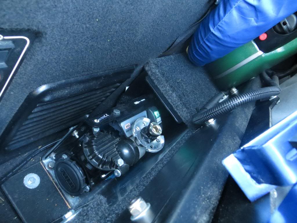

Tucked in the corner gap of the drawers is a air compressor, we constantly change air pressures in the tires on different terrains. You can also see our small grill (the green thing) that lives in the back for cooking if there is no wood of if there is a fire ban. The blue thing is a popup shower cubicle.

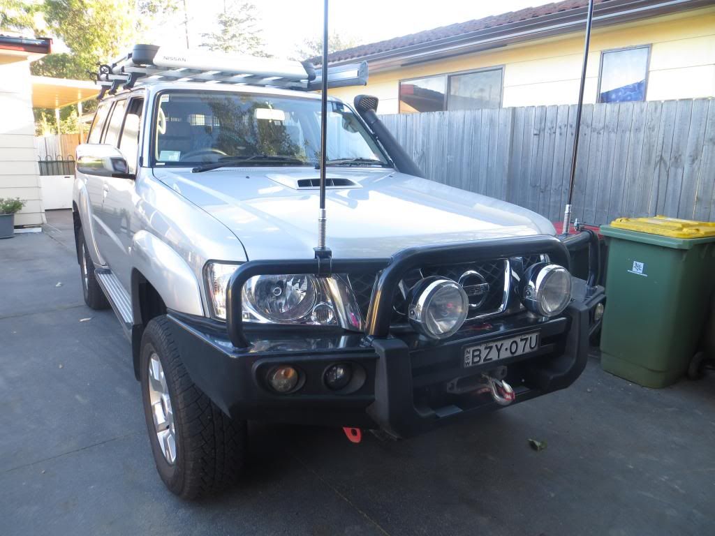

Up front there is a steel bar, warn winch, upgraded recovery points. The ariels are UHF & mobile phone.

Here we are fully loaded at the start of the year, we are a few thousand metres above sea level here -
