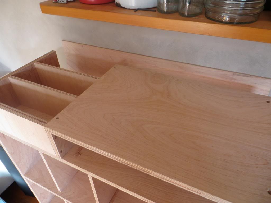

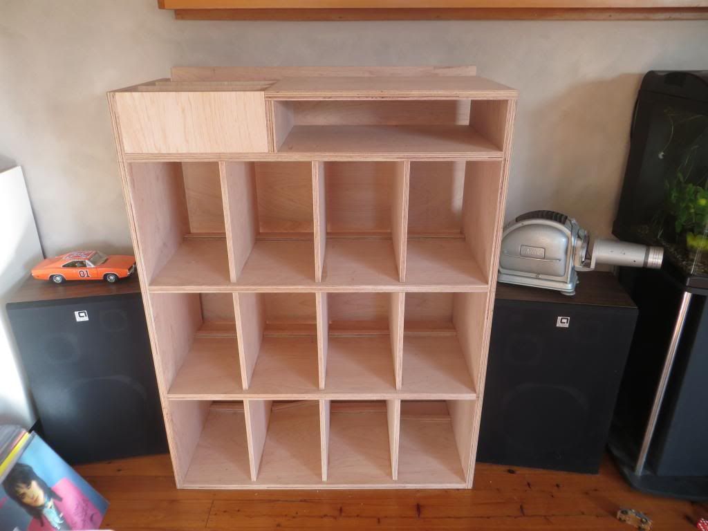

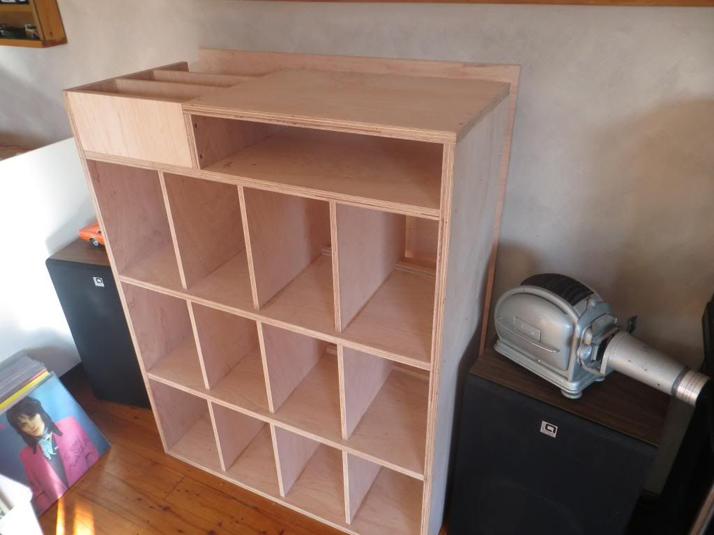

So after Jeremys Miailbox project I thought I would share my latest. I guess you can call me old-school as I still listen to music on a record player. I dont expect many people to understand but if you are into Vinyl you will know what I mean. Listening to music on vinyl is the ultimate! Anyway I have been buying records for about 25years now, slowly 1 here & there. I have gotten to the stage where I have some records shoved in all spare spaces around the house. So it was about time to fix this. I looked around at different bookshelves but there was nothing I liked.
So I decided to build my own that will house all my records, my turntable & amp. So here it is. I just made it up as I went. 3 rows of records plus a small shelf for my amp & my iPod. The turntable will sit on top & any current playing vinyl will sit in the dividers on top. I used some Fijian Cedar ply wood. To make this I used 1xsheet of 19mm, 1/2 a sheet of 12mm & 1/2 a sheet of 6mm to build it. This timber is beautiful, awesome grain. Today I have some decorative strips to glue on the ends to cover the ends showing the ply. After that I am staining it to match our teak furniture, then probably rub in some Danish oil.
So these shelves are right beside my track so I can listen to tunes whilst working or running cars. In saying that my new shelves are covered in teddybears & barbie dolls. My daughters thanked me for building them a dolls house. They have been plying in it all week. I just hope I can reclaim it back!
So does anyone else still play Vinyl? Turntables live on!

Nice work Greg.

That is pretty nice!

Thanks for the comments. Any woodworking guru's in the house? I need to putty up the holes. As mentioned ill be staining the wood. Do you use putty of the color it is now or the colour it is going to be after it is stained. ie Does the stain color the putty?

Love the woodwork and the cabinet design. What are you playing them on?

Anyway, here's the short version. First, that looks very nice, and if this is not something you do very often, you may want to look for something called "veneer tape", which is ironed onto the edges to hide the laminations. But then, that's a really good job, so maybe you know all about that, and this isn't your first time out.

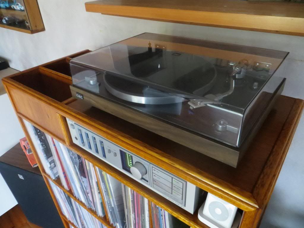

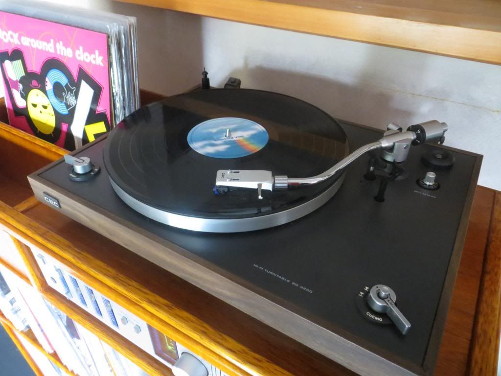

ANyway back to vinyl. My turntable is by CEC. Its a pretty good model. CEC makes most of the big names turntables. Its probably 1980s I suppose. I upgraded the cartridge to a very nice Shure cartridge & it sounds very nice. Pity the price tag on the cartridge wasnt nice! My amp is average & am about to upgrade to a nice Rotel I think. My setup is probably pretty average but it does the job nicely. It matches the style of music that I play. Ill photo everything once its all complete. Music Im all over the place as well Like Rob. I listen to anything from 50's/60's Rock-n-roll - Bill Haley, Chuck Berry etc to Old School punk - Ramones etc to modern punk - Bouncing Souls etc, to Old Jazz - Miles Davis, Louie Armstrong, a bit of modern alternative rock - Black Keys etc, Rockabilly - Stray Cats etc then theres The Beatles, the best band of all time! So yeah Im out there, I just love music!

Oh yeah Rob the vaneer tape. The wood store I purchase the Ply wood from said that the tape is not available for the ply I purchased. I purchased Fijian Cedar as I wanted it to match our 50's teak furniture & its a close match. I could of chosen a tape that was close but he recommend with the kids to use some thin moulding as the tape is quite delicate & easily chipped. The moulding is more hard wearing.

As far as your wood filler question goes, You can buy stainable wood filler at your harware store. we use it in the shop I work at and it seems to do all right. Test it with some scrap first. Also, as for staining I prefer the Minwax brand for most things. Its easy to use. Depending on what grit sand paper you used to sand your cabinet will determine a lot of your stain color. The finer the grit the lighter the stain when you wipe it. Another little trick is to wipe the area to be staind with a lightly damp cloth just before staining. It helps open the pores in the wood.

I stopped using Minwax years ago, but only because I lived where it was hard to get a decent selection. I use Zar now, and its very very good. Minwax does make a product I use often, though. They have a pre-stain wood conditioner for soft woods that is excellent, and I don't have to bother with mixing some up myself. Best of all, it is very consistent, so that little routine nothing step, that is vital to good staining, is perfect every time.

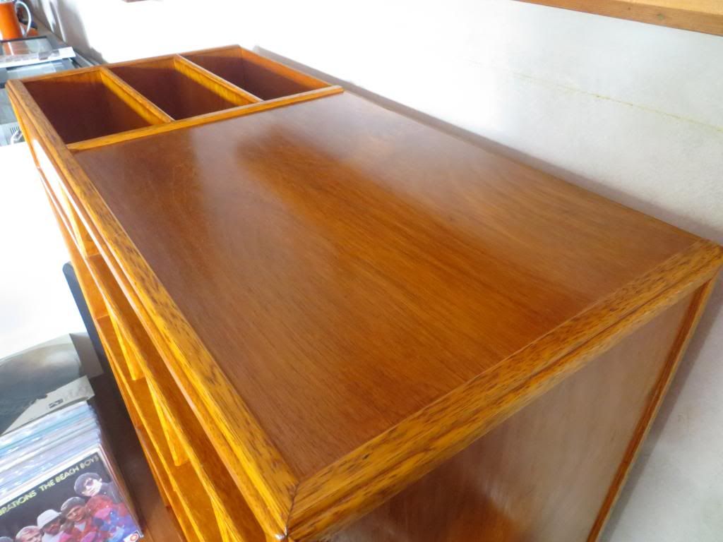

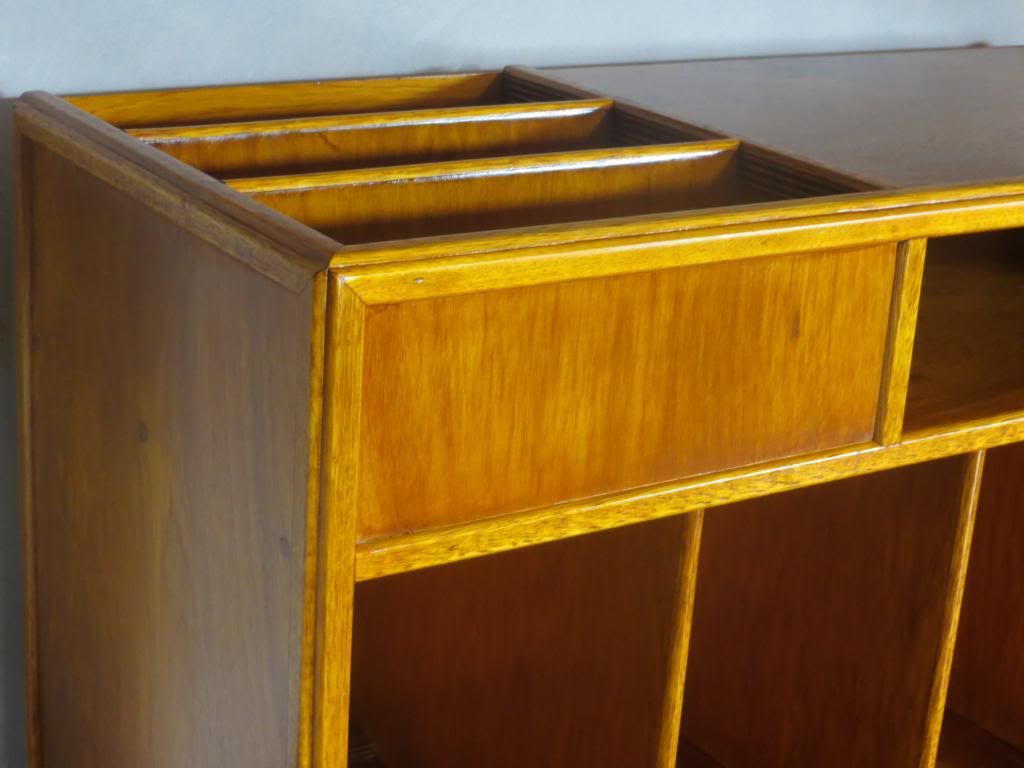

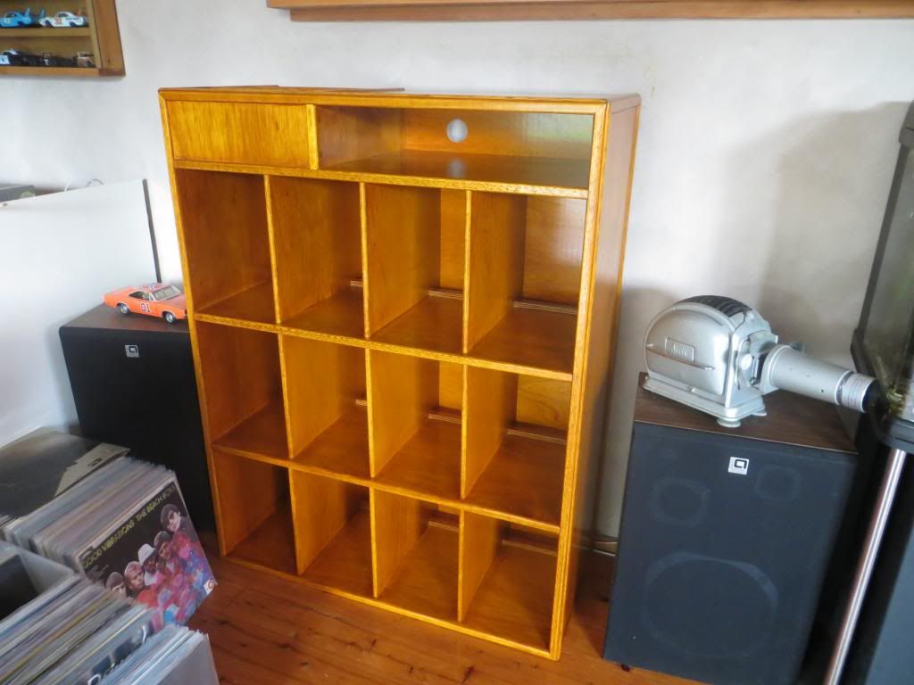

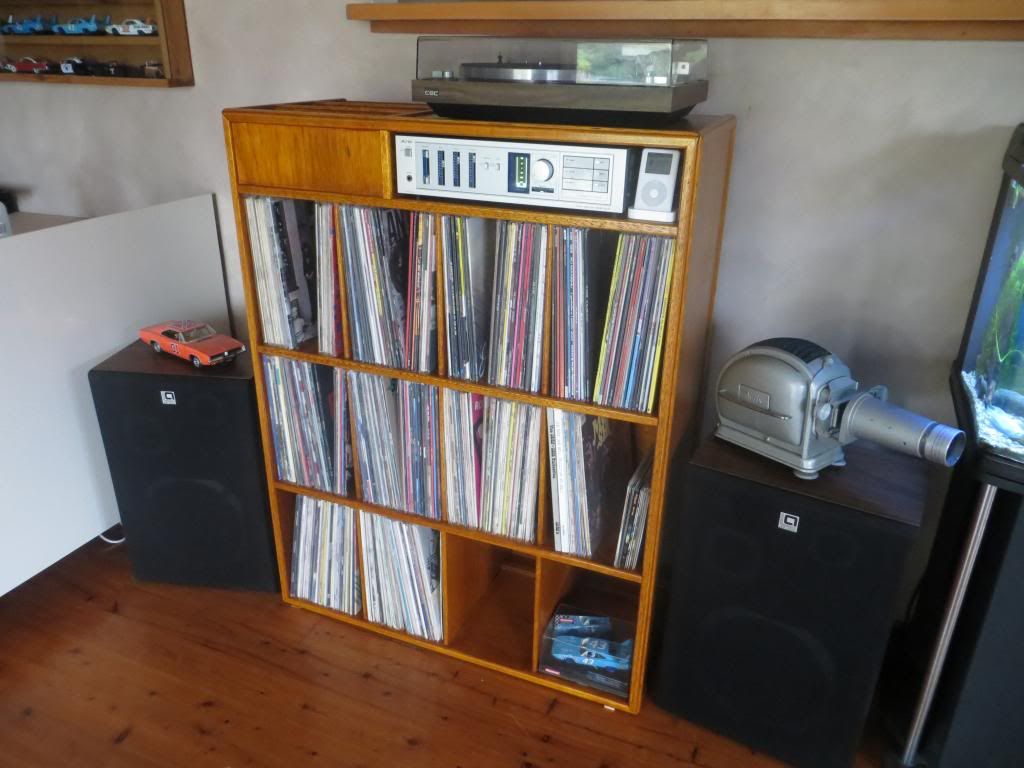

Ok this project is done. :) Sweet. I have to say Im pretty stoked with the outcome. When I first planned on building this I had no idea the finished product would look like this. Originally I had planned to just build something out of recycled timber or just some pine. I even thought about buying something from Ikea.
So this is made from Fijian Plywood. I added on the trimming. I decided to go with thin trim rather than the stuff on the roll. Mainly because of the kids & Ive heard that the tape is quite fragile. The trim was some Tasmanian Oak. I rubbed in 2 coats of golden teak stain(oil based). I played around with the stain as I wanted a bit more red in it to match our darker teak furniture. I couldnt get it quite right & the stain is very expensive to buy heaps of different ones so I just went with the golden teak right out of the jar. I wish it was a bit darker but Im super happy with it anyway. Then rubbed & burnished in 3 coats of Danish oil. I really was suprised with the shine that came of it after 3 coats of oil.
Here it is empty -

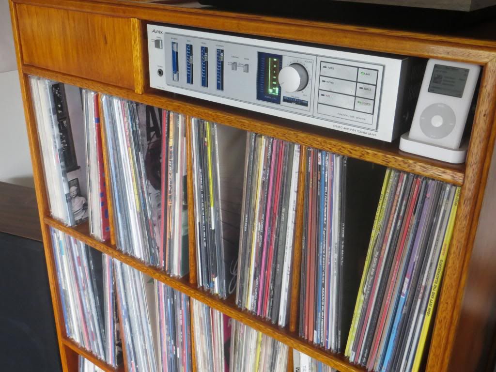

Loaded with vinyl -
Spinning my first vinyl -
Im buying a new amplifier in a few weeks as the one in the photos is pretty old & not to fantastic. I have some more records to go in there as I have a load of Beatles records I need to pickup from my parents. They will probably fill up a whole divider. Anyway Thanks for looking. Now time to get back into building some new slot cars.

Very Nice build Greg!Perfect for your collection.
