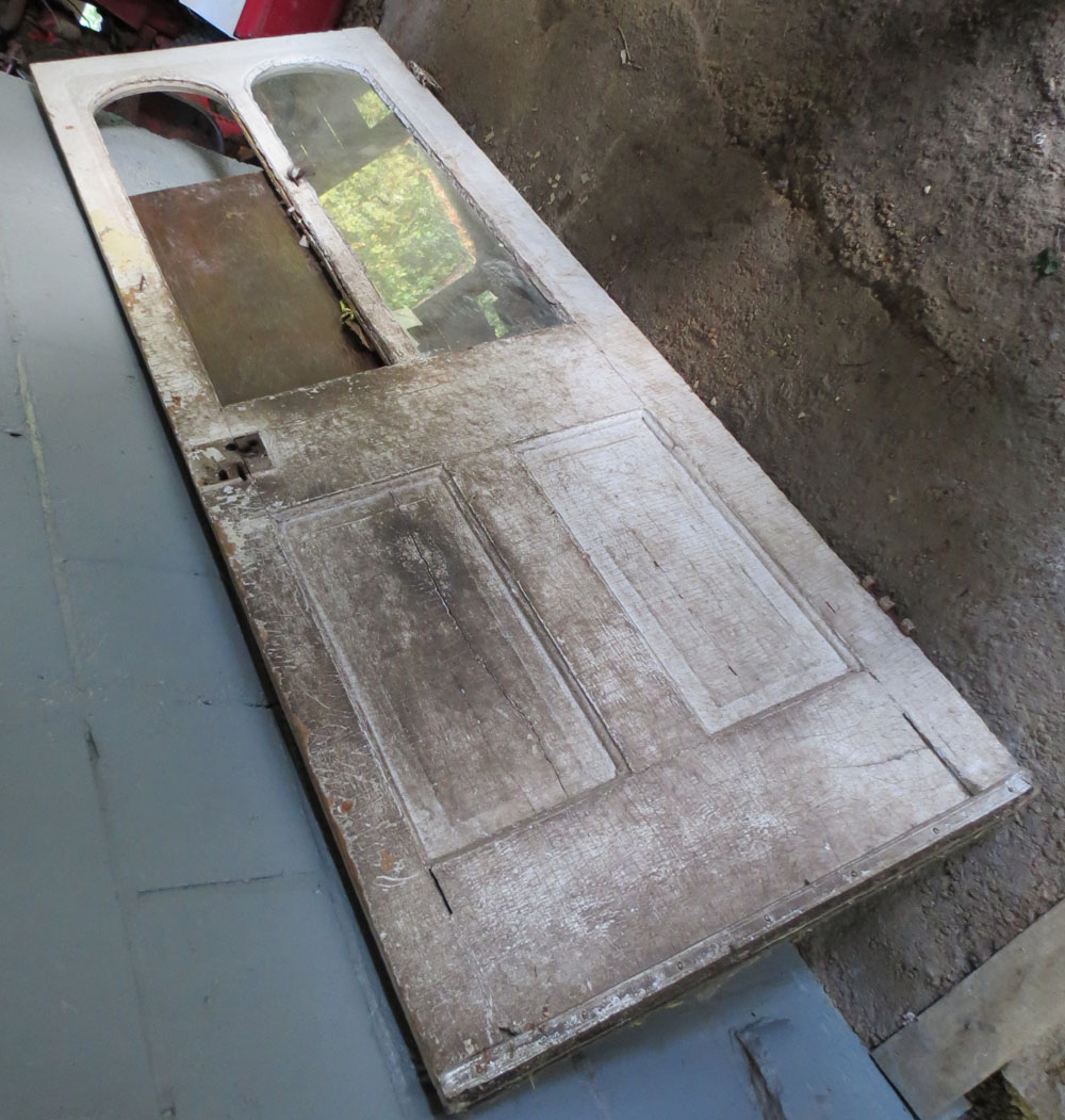

The General found an old door from a house being torn down. I am betting it is from the 40's. It has seen some wear but still looks like it could be brought back to life.
Any suggestions welcome :) And thank you.

It is rough as a cob, but under all the ugly there is a nice piece I am sure.

Some of the older doors that had a lot of millwork on them, like those arched top glass panels, were made from red oak, with inserts made from other woods, like the maple that Jeremy mentioned. They were sold as paint grade, and saved big money for the builder. These paint grade doors were almost always intended for interior use, or in situations where an exterior door was used in a protected area, like a large porch or mud room. Still others were made from red oak or maple entirely, and they were stain grade, which also meant that the cut of the lumber used to build the door was intended for display. Quarter sawn oak was very popular from 1880-1940, and was actually an essential element of several important styles (Mission, Craftsman, Morris, Stickley, etc). If that is a quarter sawn oak door under that paint, you have something very fine and valuable, not to mention beautiful.
Windowed doors of that era frequently had etched, stained, or cut glass inserts which allowed light to come through, but distorted the view, allowing privacy. The ones that had plate glass usually had curtains made from a sheer material, which was very expensive to make until the early 1900's. In the West, with fewer trees to give significant shade, some houses had Isinglas curtains, which were flexible panels of fish bladder sewn into rollup shades. I only mention it because all of these things produce marks on the door, which you may well want to avoid filling because they are historic.

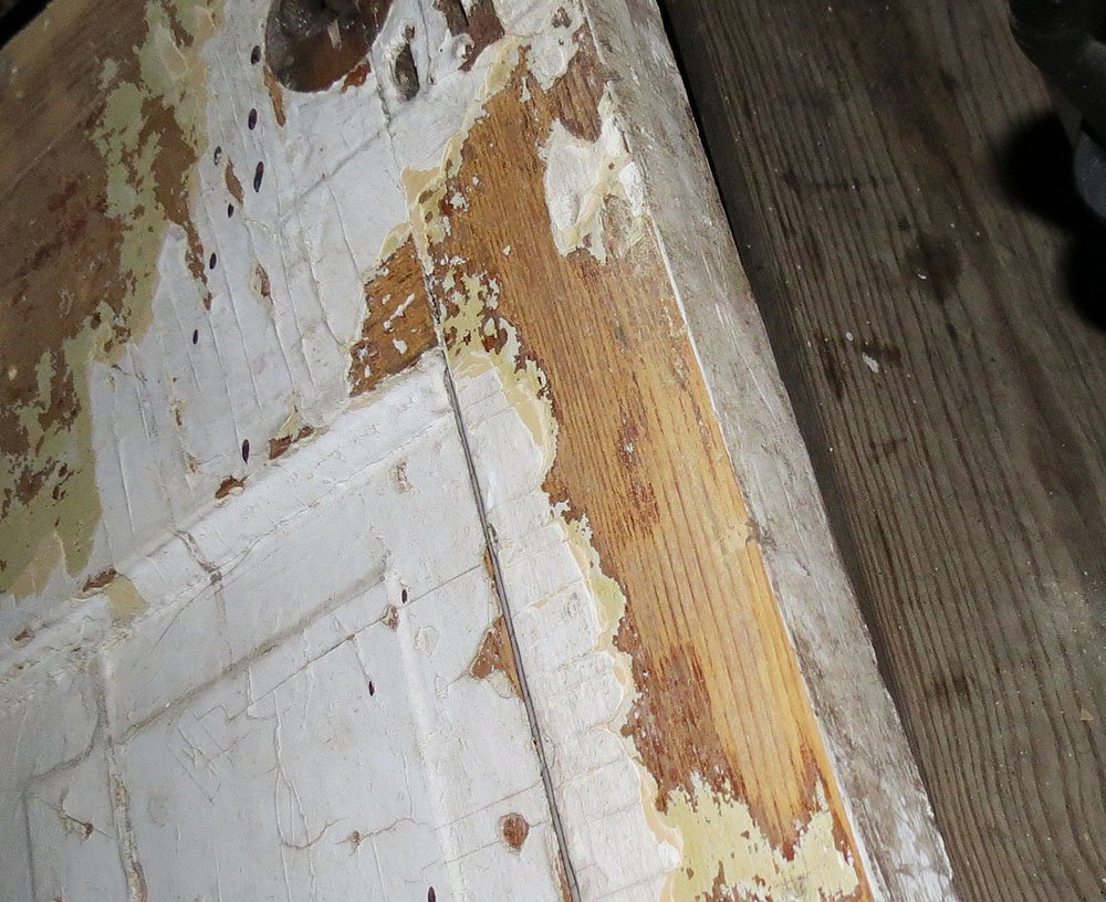

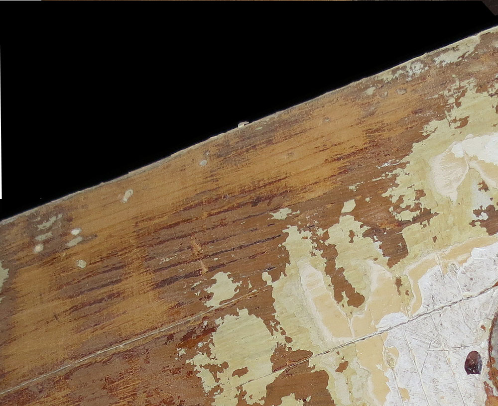

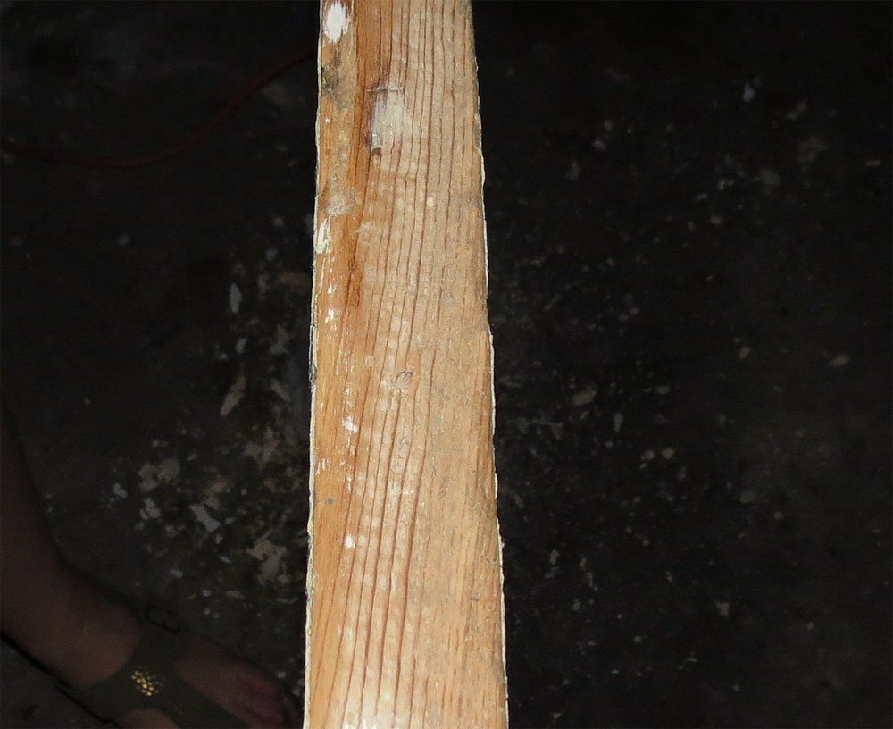

Some shots of the wood exposed. Will get some better ones in the daylight.

Ok wood experts, what kind of wood do you think it is?

Maple's a good bet, but that straight grain makes me think of old growth heartwood pine, which is actually harder. Is the door heavy? It could be hickory.
And have you knocked a splinter off it? If you put a spinter in boiling water for a few seconds, then take it out and sniff it, you might get a pine smell. Old growth heartwood pine was very sappy and dense. A century later, it will retain the sap. The same will show if its sugar maple, but you have to taste it. DO NOT put any trace of that white paint in your mouth. Remember the warning above in this thread about white lead based paint. Look in the pocket that was cut out for the lock to avoid paint.
I forgot to mention other woods. In the old days, there was a lot of lumber available that isn't worth the bother to work with today (me and Jethro Gibbs are the only ones who use hand tools). Beech, straight-grain white oak, pearwood (it actually does look like pearwood), all kinds of stuff. For an excellent look at woods, check out online catalogs for gunstocks. Usually, they give a very nice view.
