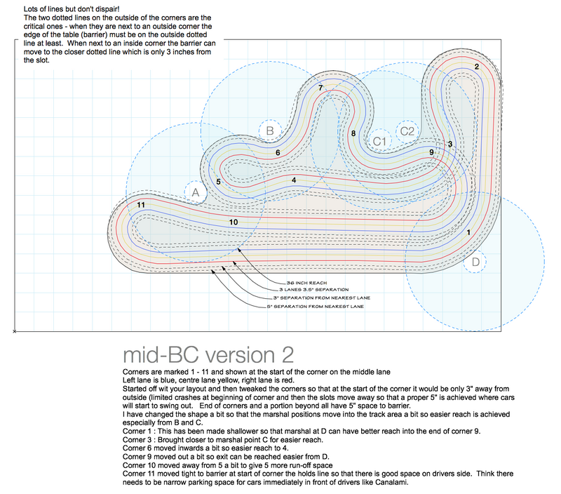

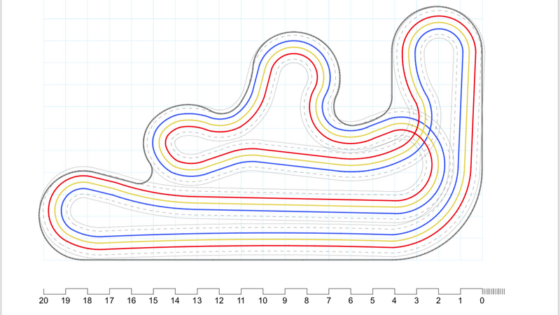

It already is...…. nice start! Any mock-up of what the actual track lay-out will look like?
Re: MID BC - new track build
Postby Cgyracer » Sun Dec 02, 2018 8:08 pm
Here it is Allan. 21 feet x 12 feet. Looking forward to running your car and the others in the Group 5 proxy on MID BC.

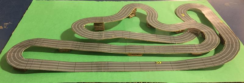

Postby Cgyracer » Sun Dec 02, 2018 8:17 pm
Marshalling positions were always in mind for club and proxy racing so we can perform live marshalling without track calls (hopefully!)
Experimenting with elevation changes.

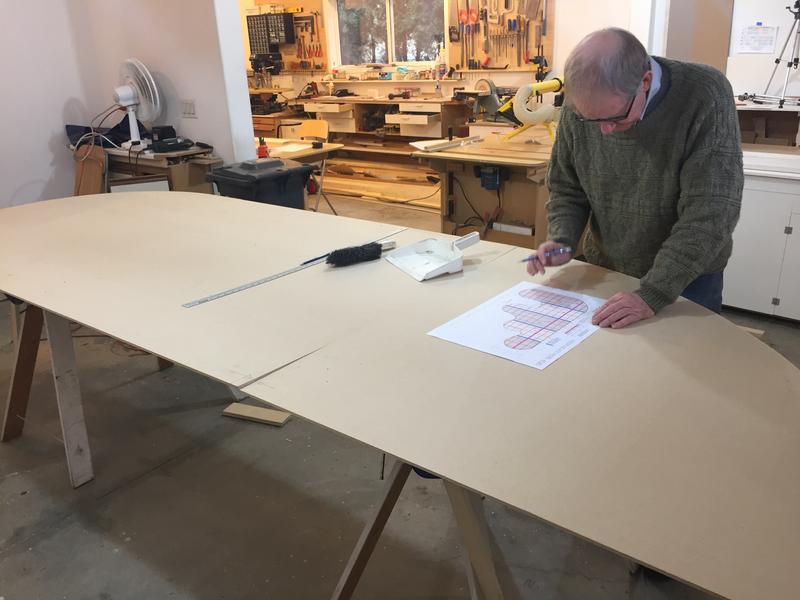

Postby Cgyracer » Wed Dec 05, 2018 10:59 pm
Last weekend we tackled the largest 49” wide piece for the tabletop. A sheet and a half was needed with a wide 4 foot radius for the end of the straight and a two foot radius at the other end.
Piece #5 was the objective
Many cuts to be able to curve the framework
Glue and clamps to make rigid
Start of the framework all glued and screwed. The 1x4 on the left is to attach the next sheet.
Sheets of 1/8” door skin cut into strips are very easy to bend and glue onto the curved framework. Three layers of door skin overlapping each other creates a very strong like 3/8” sheet of plywood that is curved and because it is standing on end very rigid for outside support
All done....one piece out of five! This framework will face up and be the attach points for the track and risers for the elevations
