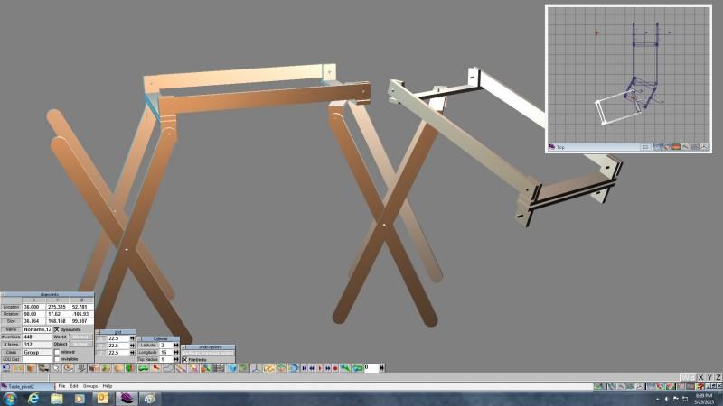

Making good progress on the 'grunt work' today.
To give you guys some idea what's going on, there are two tracks I wanted to build, Le Mans and Spa. If you know the tracks, you know that they are wildly different, so they would need completely different platforms. Le Mans is about 8 miles long, with almost no elevation change. Spa has elevation changes in excess of 300 feet. At some point, I want to build them both -- but I don't want to build track platforms twice.
So the goal is to build a track platform that is modular (easy to change length) and infinitely adjustable for height. The same module used to support the track at just over 1 foot is also used to support the track at almost 5 feet. Build a platform once, and you are done. All you have to do is reconfigure the easily-adjustable platform when you're ready to build a new track. It will work for narrow tracks, it will work for tracks with a wide footprint, it will work for huge tracks, and if you need to downsize, you can pull modules out easily. It's both a platform and a mechanical device.

Modern, actually. Working on Spa right now. It won't be a 'scale representation', because you'd lose the characteristic curves that make up Spa. Eau Rouge would barely be a blip, and the high speed downhill plunge would be a couple of sharp turns separated by 3-foot straights.
Here is the drawing I shared with Eric and Harry. This drawing is not complete, and doesn't show the leg-locks. It also doesn't show the stabilizers, but the track itself will provide important rigidity when it's screwed to the platform. Each module is essentially a scissor-lift with inverted universal joints, allowing the platform to turn and change elevation. There is also a 'universal shim' that will help keep things level through transitions, and can also be used to adjust track camber.

Postby ElSecundo » Wed Apr 03, 2013 3:59 pm
No Rob, just one at a time. But when I want to switch, I don't have to worry about the elevation difference. I just reconfigure the platform to accept the new track layout.
