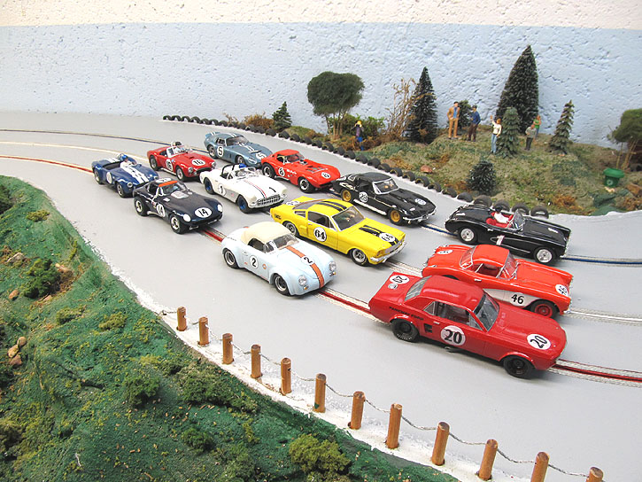

Posts with cables were very common. Weather some dowels and connect them with wound guitar strings. The "G" string is typically the smallest wound guitar string. Do not use a cotton "G" string.

Postby HomeRacingWorld » Thu Sep 19, 2013 2:02 pm
I used the wooden dowels myself and I liked the outcome.
Stained them with old English furniture polish and the "cable" is the braided wire used for hanging portraits.
Having them cut at different angles is the way they looked in many cases on roads around the country. Some were uniform, some not.
Very strong and easily modeled.
