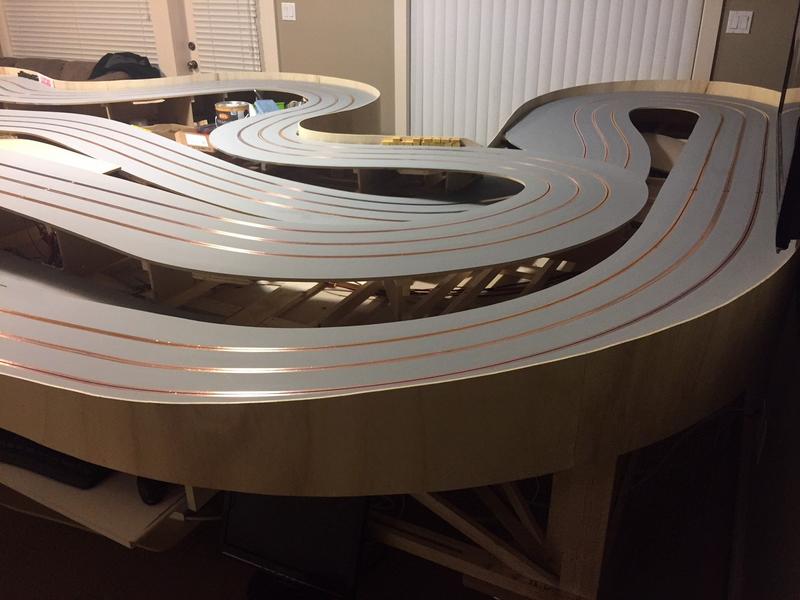

Installed all the blocking for attach points under the roadway for the flexible plywood. A little tedious with a level / gluing and clamping.
I cut strips of plywood, temporarily attached, and then marked the cut line 1.5" to 2" above the roadway during the process. Plywood was attached with wood glue and fine nails. I will punch in the nails and then fill the nail holes later so I can paint.

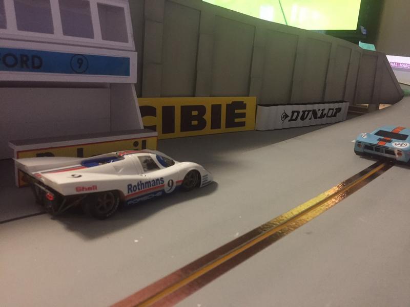

Vintage Le Mans Pit lane by GP Miniatures, I will try to go with a retro Le Mans "look".

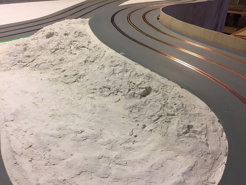

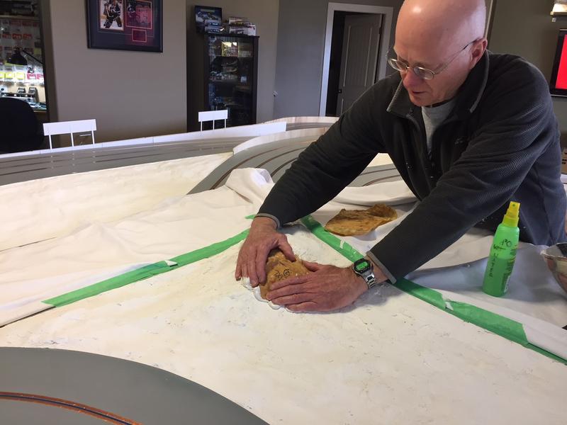

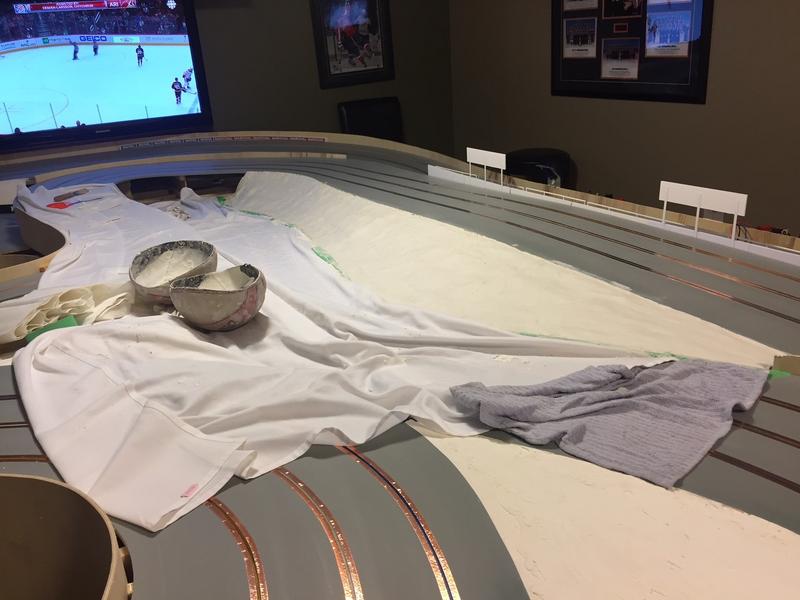

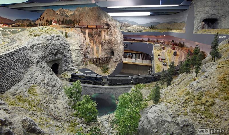

Quick update, in between racing I have started on the scenery. I know nothing about scenery so I asked fellow racer and model railroader Don to help me with the basics on what I need to do. Don's train layout was featured on the cover of the Model Railroader 2018 Great Model Railroads with his Nitro Pass RR. If I can just learn and implement a little bit of Don's knowledge I'll be happy!
Don's Nitro Pass RR

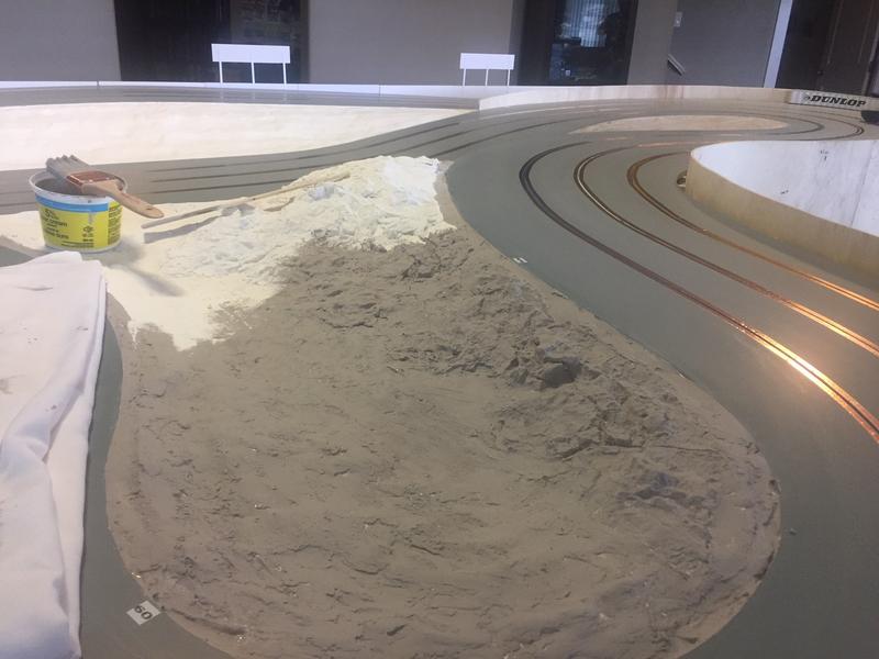

Don came by one afternoon with supplies and showed me how to start the scenic process with cardboard and Plaster of Paris.
MID-BC's first race occurred last week so that's all the scenic build I have done! I think I will be concentrating on the scenic build now that racing has wound down for the season except for a proxy or two that will be coming through.....plus I see I need to build a Can Am car I have not paid the entry for yet ....!!!

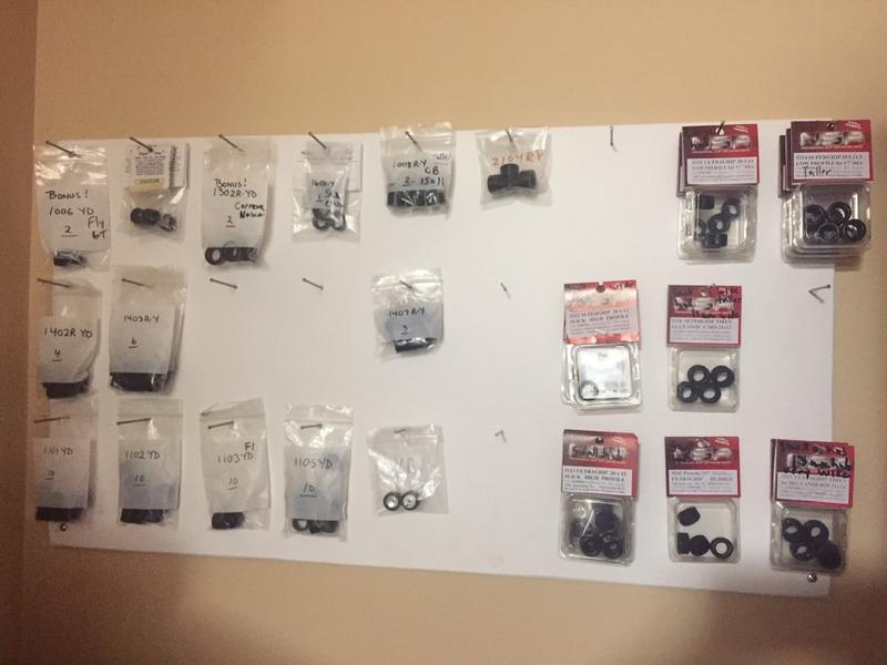

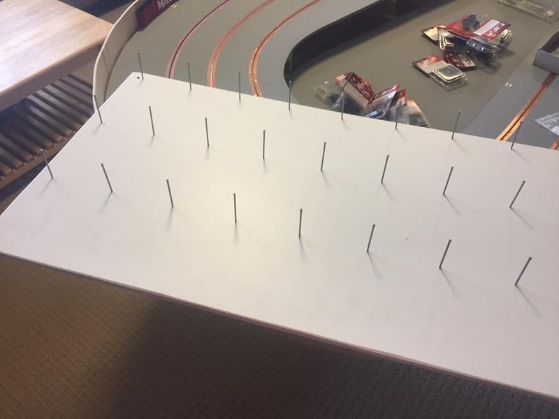

Since I uprooted my garage work area, I needed to build a new parts shelf.
Cut/Painted MDF board white with 2.5 inch finishing nails to hang parts.

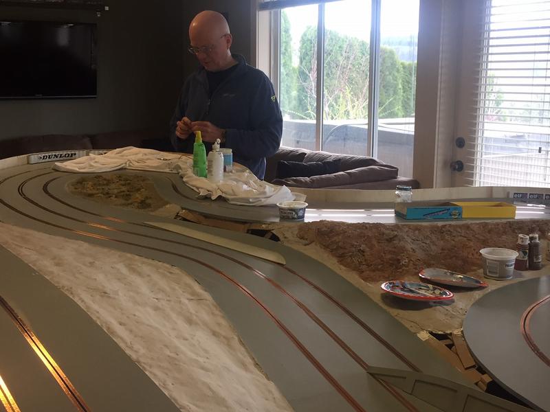

Over the past couple weeks Don came over to give me a couple three hour training sessions. This time the subjects were rock moulds, painting, and various textured scenery.
Session 1 was getting instructed on rock moulds. There are a few various moulds of different patterns he has.
I carried on with more rock, got the hang of it.
Don left me dirt colored paint to paint as a base on all the plaster.

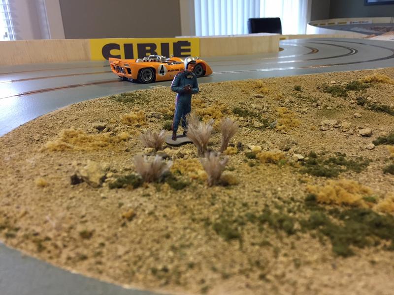

For session 2 Don brought his various sand, rock, and scenic material that looks like grass / brush. I live in the interior of British Columbia so I'm trying to replicate a semi-arid rocky/hilly region with grass and some trees.
Here in the interior of BC we have the Area 27 race track designed by Jacques Villeneuve. There are some nice video's on the web link of the terrain around the track so you can get the idea of what look I'm going for.

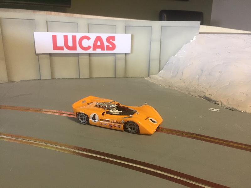

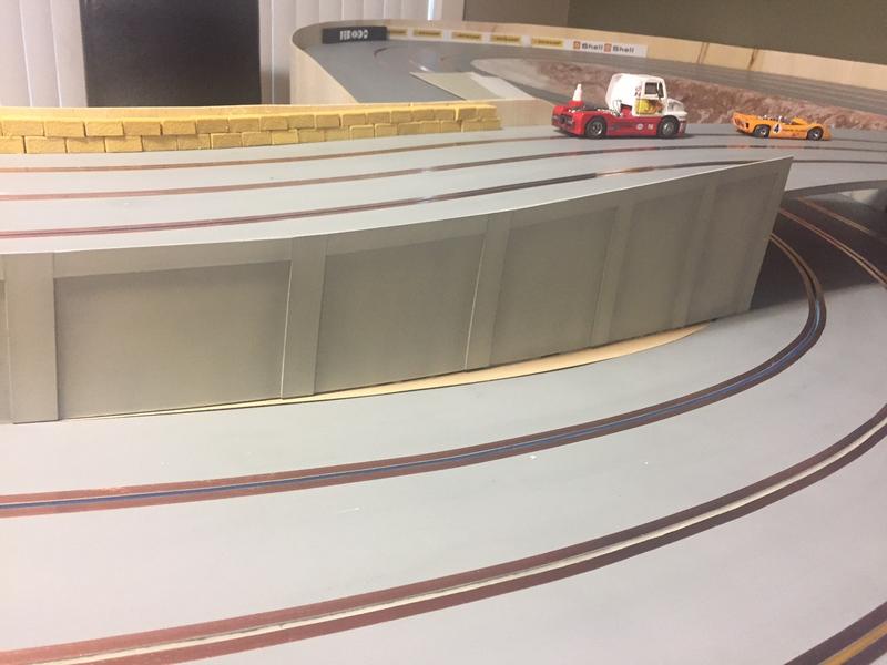

Don prebuilt me some beautiful concrete retaining walls which I installed.

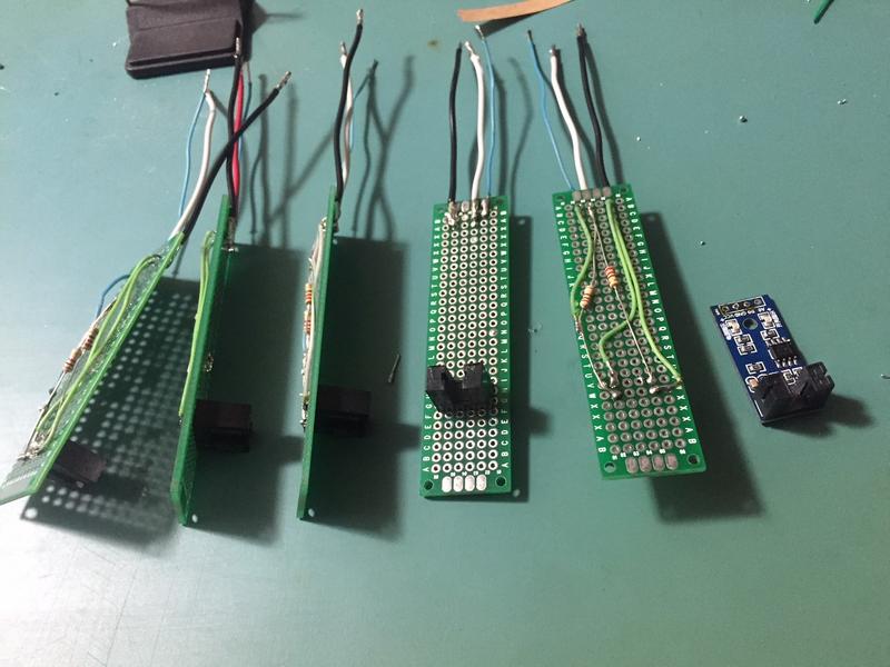

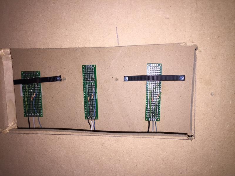

The $1.88 slotted optical sensors I used from China were not reading white or shiny guide flags. I built some new slotted optical sensor circuits from scratch that are simpler but crude looking......definitely not as good looking as the blue Chinese sensors I bought. In the end I used a pull up resistor of 2K ohms that seems to work well for me to receive a strong signal for all various guide flags. It was not expense to build these either.
The little blue one is one of the Chinese circuits I purchased, told ya my self made ones don't look good!
Installed into my track.

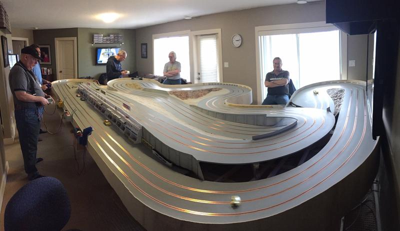

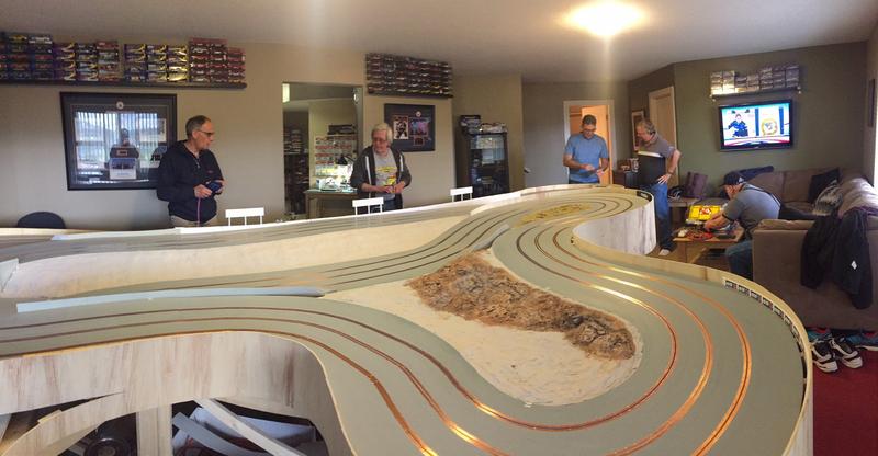

Had some guys over to tune yesterday while I visited
