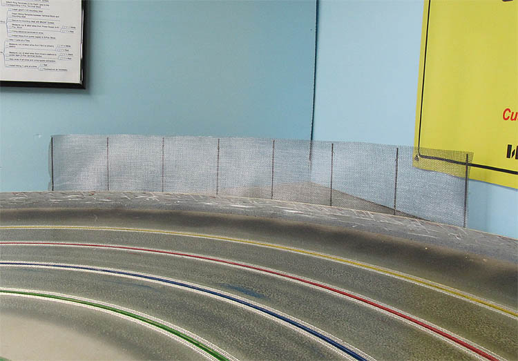

Wanted to get a fence put up on the old oval for awhile. Needed something that was strong as well as looked somewhat scale appealing.
I used 3/32nd steel rod from Lowe's. I measured and spaced the rods about 4 inches apart. I drilled a hole into the mdf the same size and tapped the rods in with a small hammer.
Then I spray painted some plastic door screen I get at Lowe's silver. Finally, I used craft wire to loop through and secure the screen and the bottom edge that cannot be seen is sealed with a bead of hot glue.
Looks ok to me. It will also help keep cars from falling out into "The Dead Zone" where it can be hard to reach :)

Looks great Harry. That should last a while. Jim

Postby dreinecke » Tue Jan 01, 2013 11:37 pm
I agree, I really like how it turned out. Besides, some knucklehead in a purple Mopar kept sending me off there...

Looking good - you need to do a tutorial on Pray Painting though I haven't tried that technique :)

Awesome looking fence Harry!

Harry, you'd better put more of this up everywhere around the track!

Harry,that fence needs a touch of rust to give it character.

Yes it does.
I am doing the other end now. But I am going to have to use the stronger plastic gutter guard there. We race too hard and just don't think the small screen will hold up.
