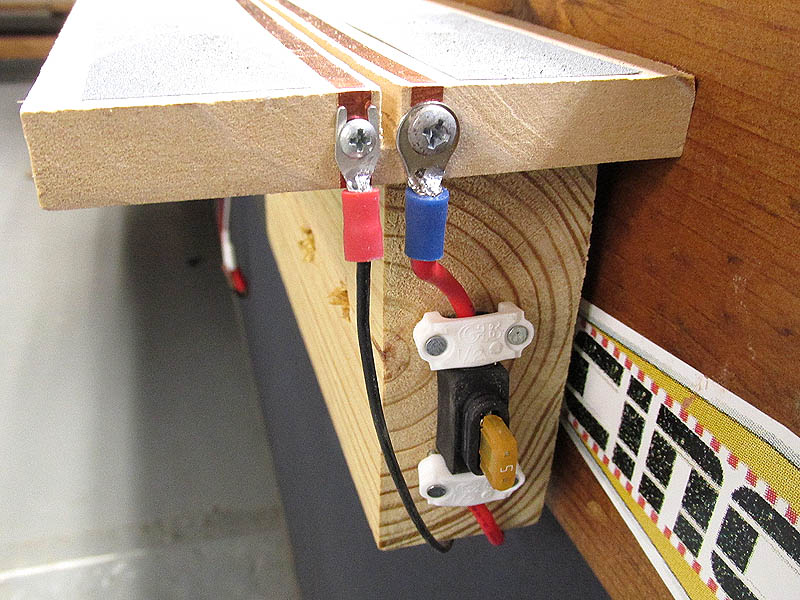

Postby HomeRacingWorld » Tue Apr 29, 2014 5:54 am
Thanks guys. Dang it, you are right Kurt, knew I cut those slots a little too long :)

You might want to cover the scuff stations with a mat when they are not being used, someone might put something conductive across the tape and that would not be good, especially if you have a big power supply and the driver's stations are not indivdually fused.

Postby HomeRacingWorld » Tue Apr 29, 2014 8:17 am
Thanks Rich. They are fused though, used the same ATM fuse holder as on our road course.
Might be a crude way, but I like the simplicity of these fuse holders.
