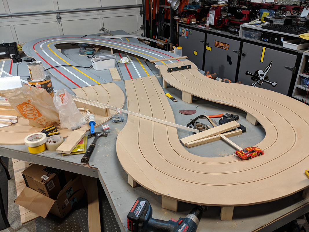

I used a 40 year old Craftsman, probably a 1 1/2 or so. It was a full size router. I bought a new HD trim router to do the gains so I wouldn't have to change bits and could leave depth set permanently with both bits. After finishing, I think I might try the trim router for the full job next time. It is not as a stable as a full size, but mdf cuts so easy that it can cut it easily enough. I think if you rout with some kind fence for a guide the trim router is fine. Maybe if you use a compass arm to cut curves, a heavier router is better. Just thinking about how much base you have to mount a guide to.
I will not do this again without have a second pair of hands to hold the shop vac hose behind the router.
I am intending to do a mod to one end of my track after the first of the year. I am going to make a flat curve a larger radius, wider lane spacing and a little banking. A few of the guys that race just can't make it around that corner. Better to re-work it then to have cars coming off every lap and the fun factor low.

by chappyman66
It has to do with the width of the router base and the degree of banking. If the corner is tight enough, the router base lifts off of the wood and rides on the edges of the base that touch the curve....which decreases the depth of the slot. Which, when cutting the braid gain, is critical. It's harder to control the router for a smooth cut, too.
This is why long cars will sometimes deslot on the older banked curves.
You can go back and make multiple passes to increase the depth, but that's a PITA.
Routing flat eliminates all of that. However.... sometimes the slot will close up a bit if the banking is tight....so you still need to run a guide through to make sure everything is clear.
A trim router has a much smaller baseplate to start with, but it does have less power. For a small oval, it's all good.
