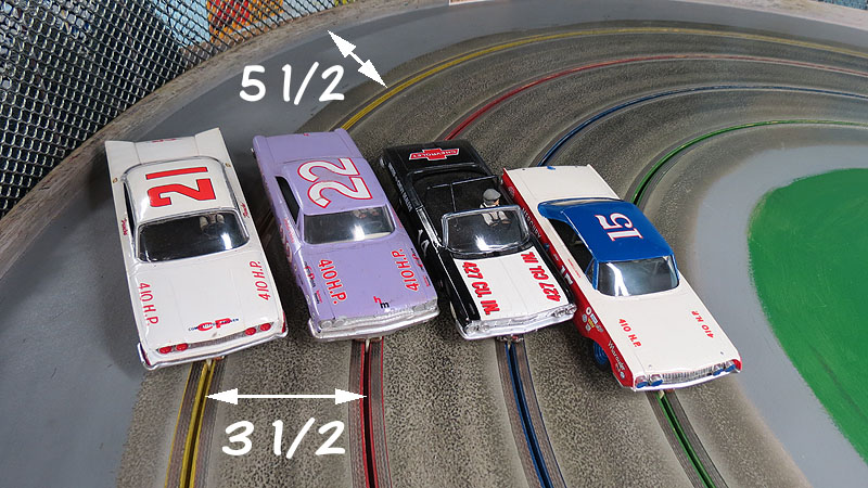

I am thinking 3 and 1/2 " spacing, copper tape and the power supply and lap, counter I am alread using.

Cutting out and lowering the non track areas would be a nice visual feature but not necessary. 3 1/2" spacing is good for most 1/32 closed fender racing and you could also run some closed fender 1/24 but with a lot of fender rubbing. but is tight for open wheelers if you want the ability to pass other cars without tangling wheels. As to outer apron width, I would set it by the longest car that you want to run. If the angle of the car is too extreme to allow efficient rail rubbing in the outside lane, you have enough. I run 6" on my 1/32 sized oval. I think that would be enough for 1/24 sized sprint cars but might not be enough for big & long 1/24 sedans.

For the open wheelers, I would go 4 if you can. My lane spacing is 3 1/2 and can be tricky with them. 4 inch allow more breathing room for them and reduce the wheel contact.
1/25 scale. The outer apron is enough for us, but personal preference of course.

Thanks Harry for, the pic, its worth a thousand words lol
