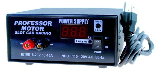

I've been using a Professor Motor PMTR1400 15 Amp 6-20V Power Supply for my Tire Razor for over 5 years now and it's never let me down.

BTW Slot GT, that looks like a nice option, but also looks like it could be pricey? As I mentioned in my original post, I’m trying to keep the cost well below a 100$ (and CAD $ at that) as I just want a dedicated and portable power supply for my truer.

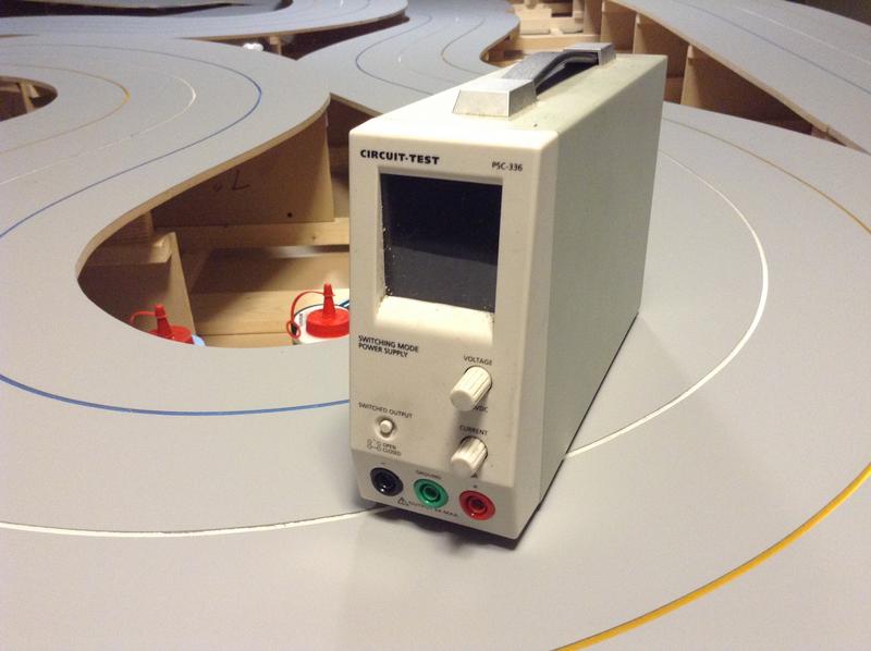

Hey Tom......I use a 3amp power supply with my Hudy and Razor. No lack of power with truing rubber or urethane. If I ever have lack of power I accidently turned the adjustment knob too much! Nice and slow cut will get you that trophy Tom!
This is my supply I bought locally.
