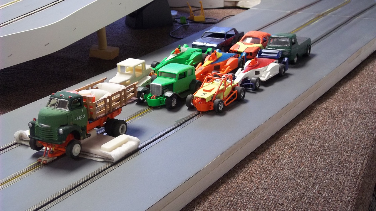

Out west the dust gets real bad so I spray the ol'49 chevy truck with some endust on the swifer and let it cruise around the track at 70 mph in each lane for three laps per lane. With the dust gone it seems to have more traction for the cars then. Image The Grand-kids like to argue over who gets to run the ol'cleaner truck.

I guess I should further describe how I use the Endust spray. I put a light even coat on the pad of the ol'49 CO, let it dry and then run it around for three laps per lane. Aft this I notice an improvement with the cars I run of 1-2 seconds per lap. This may be due to the fact that here in the CA Central Valley is for the most part dry and dusty which will leave a layer of dust on everything. Its amazing how dirty a computer can get, I have to clean those out at least once a year and it looks like I'm blowing the dust out of a paper air cleaner that's used on my mower.
This may not work for everyone but it does work on my track and it results in the tires sticking better to the track whether they are the Scalectrix or PG variety.
