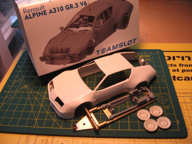

This is my last project in the west coast before returning east for the summer.
This Team Slot Renault Alpine A310 kit has been sitting too long. Always intended to re-chassis so I've got a built adjust-o-wheelbase slimline motored one sitting in the wings waiting for a drivetrain. Quite looking forward to this one.
Dan

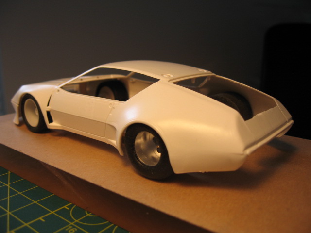

Got the chassis rolling with Slot It plastic 15 x 8 rims/Team Slot tires at the front and Mitoos F1 wheels/homemade urethanes at the rear.
Mocked the body on with the front valence/spoiler attached. As hoped there's enough front clearance so trimming of the spoiler will not be necessary.
Stance is good.
Dan
