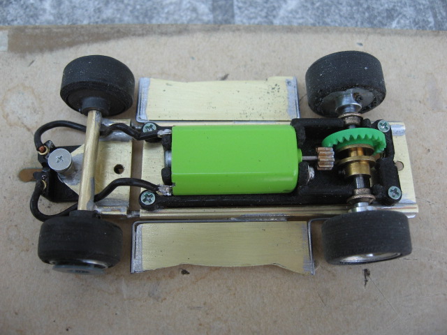

Gathered pieces of my long neglected Sprite Proxy entry from years ago.
The streamlined Bug Eye Sprite body was modeled by JTPrevia and cast by Munter. I added a fairing and filled the rear wheel arches to further emphasize the slippery look.
Going to resurrect it with one of my adjust-o-wheel base chassis with a 3D printed FF050 motor pod. These seem to work well on my small car builds so going this route.
Dan

Postby VTECFOUR » Fri May 31, 2019 4:12 pm
@munter - Hi John. Seems so long ago that we ran the Sprite Proxy. Was a lot of fun with many interesting builds in such small packages. BRAIN's all wheel drive car particularly comes to mind.
My resurrection is coming along with the new chassis assembled.
Seem to recall that the wheels are Slot It 15 x 8 with Porsche 956 inserts.
Dan

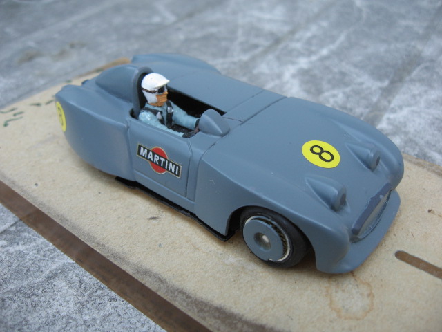

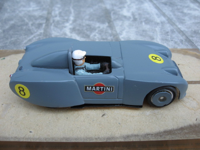

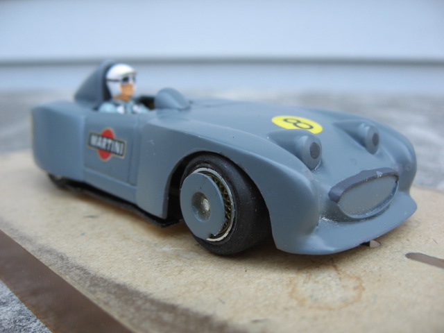

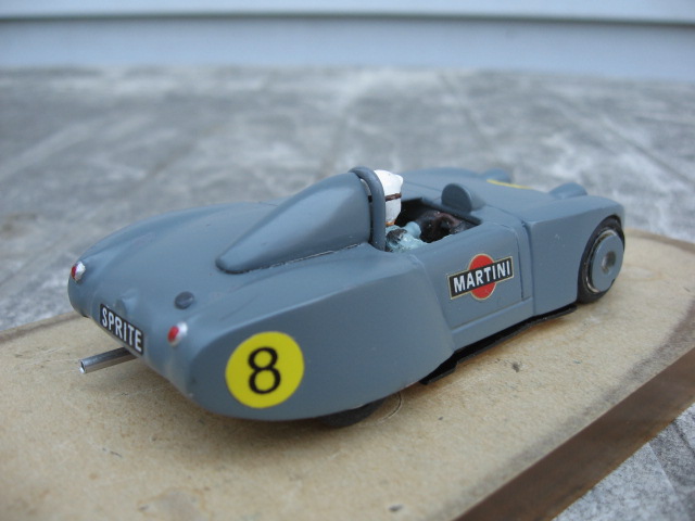

Postby VTECFOUR » Sun Jun 02, 2019 3:32 pm
Resurrection done!
Chassis assembled with the usual materials.
- 3/32" brass main rails
- .064" brass sheet for the guide tongue and crossmembers
- .064" piano wire slide rods
Same goes for the running gear...
- Scalextric Sport FF050 green motor, 25K
- Slot It 9t pinion for 1.5mm shaft
- SCX Pro 27t crown
- Slot It 15 x 8 aluminum rims, front and back
- shaved down Slot It front tires and home made urethane rears
- Slot It Porsche 956 wheel inserts
...and other pieces
- Sloting Plus Universal guide, 7mm deep
- Slot It tinned braid

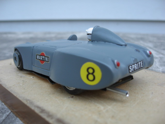

Body's mounted with the side pans trimmed to the contour of the body sills and blacked out.
Modeling-wise, did a little exhaust pipe of 3/32" aluminum tube fitted onto 1/16" piano wire that conveniently fits in one of the chassis main rails. Also did some gray brush paint touch up of the inevitable scratches and gouges from the proxy racing.

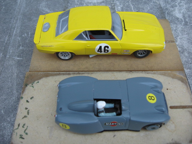

It's a small car compared to a Scalextric Camaro so can be a handful with a powerful motor.
Runs and looks good, so I'm fine.
Dan
