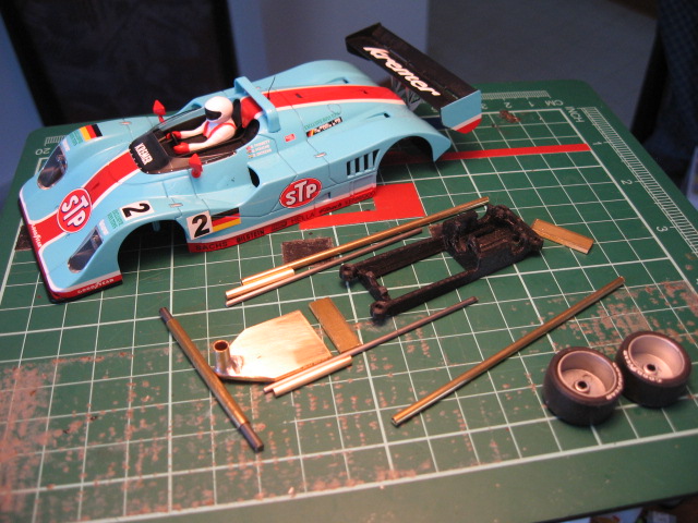

Back to 1/32 after a string of 1/24 builds.
Had this Avant Slot Porsche Kremer body for awhile so time to build a chassis to get this running. Building one of my adjust-o-wheelbase hybrid chassis using a 3d printed FF050 slimline motor pod. Found these inline chassis are suited for small and light cars yielding good performance.
Cut, prepped and assembled the pieces including,
- .064" brass guide tongue
- 5/32" brass guide post tube
- 1/8" brass front axle tube
- 3/32" brass round front axle supports
- 3/32" brass round tube main rails
- .064" brass front cross member
- .064" brass rear cross member
- .062" piano wire front assembly sliders
Ran out of my usual 3/32" square brass for the main rails and front axle supports so going with what's on hand, 3/32" round.
Should be rolling soon.
