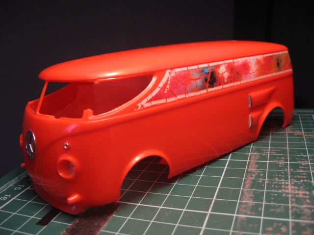

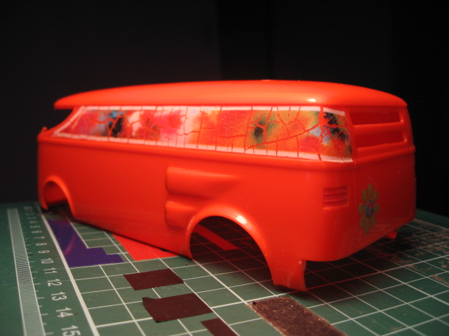

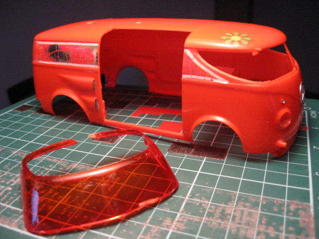

Building a potential Holeshot Winter Nationals entry based on the old Monogram VW Baja Bus body. Spotted at the annual spring car model show n' sale, it was missing its two-piece side door/ramp along with the rear valence and both A-pillars were broken off and missing. At least the one-piece tinted window assembly was there.
Coincidentally, 3DRon, our club's 3D printing whiz was attending the show so I asked, "Could you scan the good side and reproduce a door?" With a quick look at the body, he responded resoundingly, "No problem".

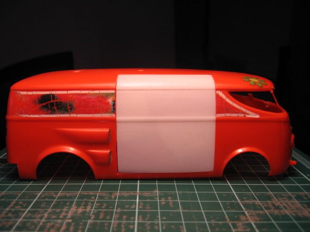

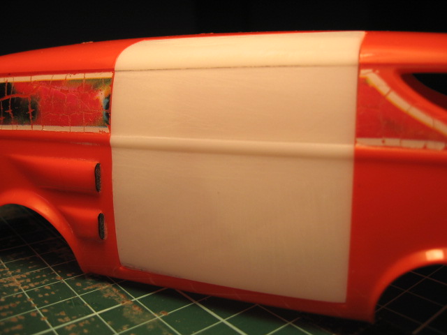

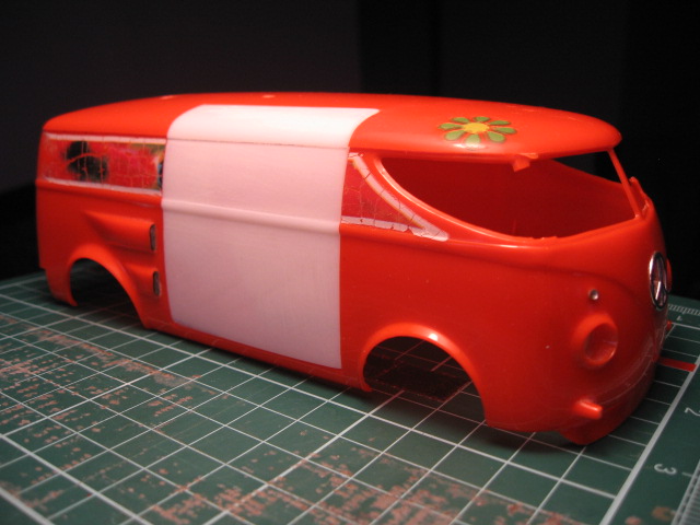

So, here we are with the 3D printed one-piece filler with the body detail faithfully reproduced.
A big job nicely taken care of.
More body repair then painting and underpinning with a simple ladder chassis.
