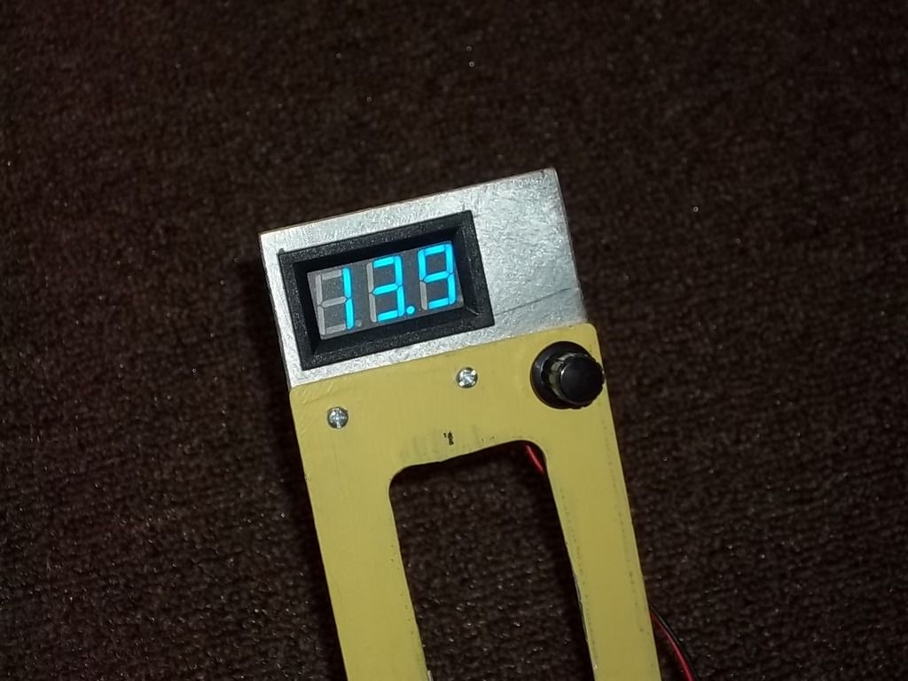

Postby ccobra » Tue Apr 21, 2015 7:38 pm
I've had a Plastic track for a few years and I really enjoyed that I could change the layout on a whim. But then a couple of years ago I made a 3-lane wooden track so that I could run the cars with my two grandkids. That was when I got tired of picking up their cars to place on the track and then redo the same process at the next turn. My fix was a simple order placed to Amazon for a digital voltage meter and a DC motor voltage regulator for each lane. Image I installed one for each lane so that I could still run full voltage while turning their lanes down to their ability. Funny part even though I 'm running full voltage, it is difficult to keep up with their partial voltage but they don't mind for they are beating Grandpa at his game. Only problem now is my daughters added more grandkids and I am back in the same boat, being on the sideline, I should have made more than three lanes.
