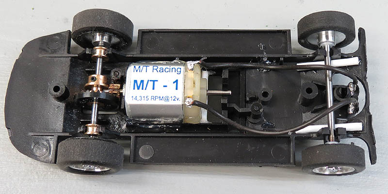

Postby HomeRacingWorld » Sat Dec 07, 2013 3:01 pm
For what it is worth, a session on your tire truer, some good PG's, blocking the front axle to remove vertical play, and some lead placed in the right areas.

Postby HomeRacingWorld » Sat Dec 07, 2013 5:45 pm
This shows the front axle mod, and I did sand the outer edges of the chassis.
So NC-1 or not, these mods do seem to help a lot.
