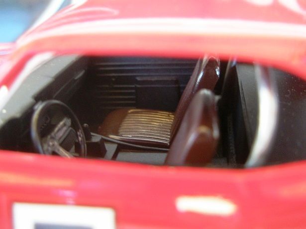

Postby Reslotted » Sun Mar 23, 2014 11:41 pm
Using the Snap tite interiors works out, if you cut out the back seat and box it with plasticard to clear the Motor, this is a snaptite Camaro.on a pioneer chassis, driver was fitted later.
