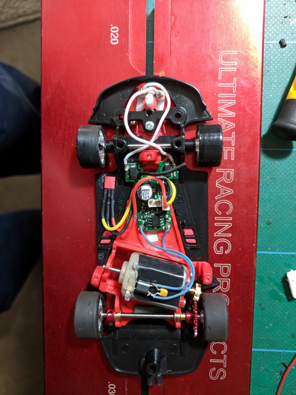

Postby GRUNZ » Mon Apr 23, 2018 2:45 am
HI Chris
I took inspiration from your post and build one of my NSR 997 with your configuraiton.
Here in Auckland, we run these 997 with oXigen and the NSR Baby King.
I wanted to try your approach and put this 18K MRRC shortcan.
I have to say that this motor does not have the grunt as the Baby King.
After I took the picture I have upgraded it with a Piranha motor and it is much better now.
What I really like (at least on a plastic track) is the less brutal magnetic effect of the motor compared to the baby king.
GRUNZ
