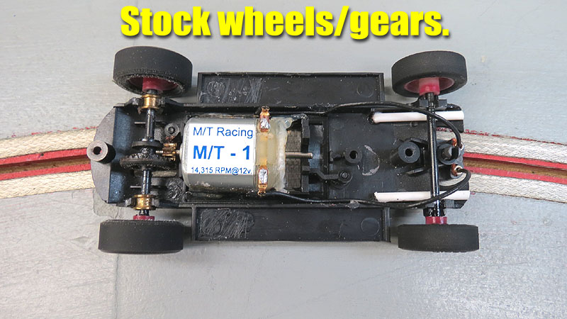

Harry, those look like aluminum wheels all around. That's how the crown gear change came about, right? Why did you forego the converter from later motors to the NC-1 configuration? I have a stack of those converters, but if I don't need them, maybe I shouldn't waste them.
Re: Ninco Jag (correction added)
Postby HomeRacingWorld » Sat Dec 07, 2013 6:33 pm
Are you asking why I did not use a motor adaptor to mount the motor? If so, because I just make a styrene bar and glue them in. Seems to work ok, and I was out of adaptors.

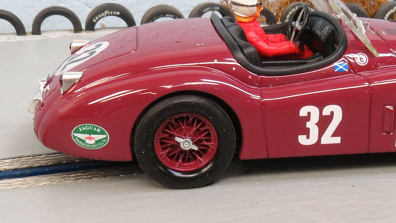

The wheels...yes, this was a car from Pendle. It came with no motor and I bought the Penelope Pitlane wheels and just dolled it up all around. It was last seen laying in Doc's box as he boarded the plane home.

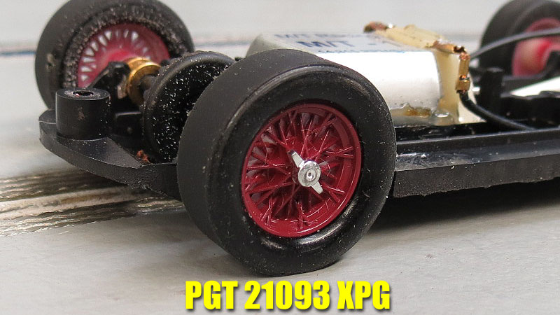

The tire I like is the PG 21093 XPG. You have to sand it to get the right diameter, but you would do that anyway for truing.

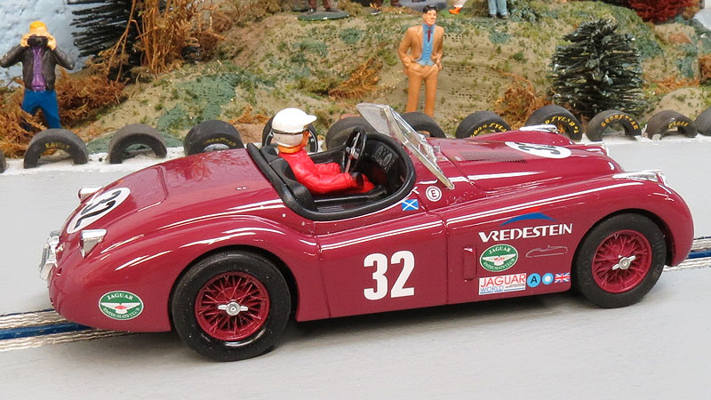

Ok, pulled this one off the shelf and gave it a tune.

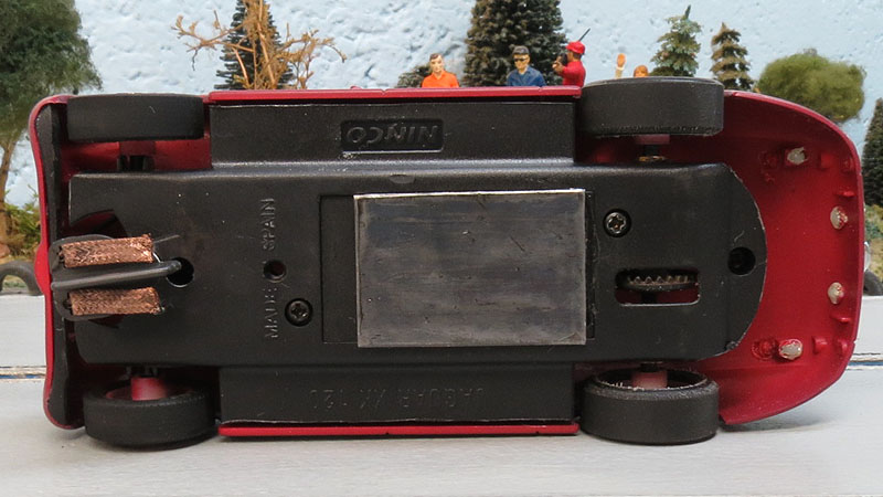

Chassis sanded. Front clip removed and glued to the body. MT motor. Front axle shimmed up. Stock guide. Scratch motor mount again.
Little lead in the bottom.
Tire change.
Runs great. Most won't like the chassis mods, but I like to try new things. This old ride has sat on the shelf too long and this was fun.

That silver 140 hardtop is a beautiful beast. Actually it might be a 150. It looks straight along the top shelf line... no hips.
