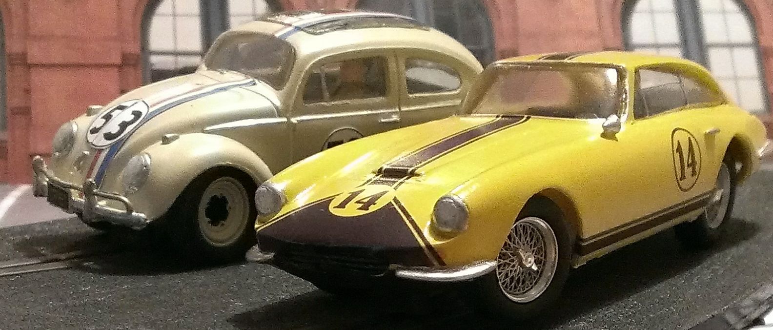

I'd already decided that I wanted to make a Herbie slot car
But these things run better together, so I needed an Apollo to go with it. There wasn't a model kit or toy in existence so I got a 3D artist to model one up.

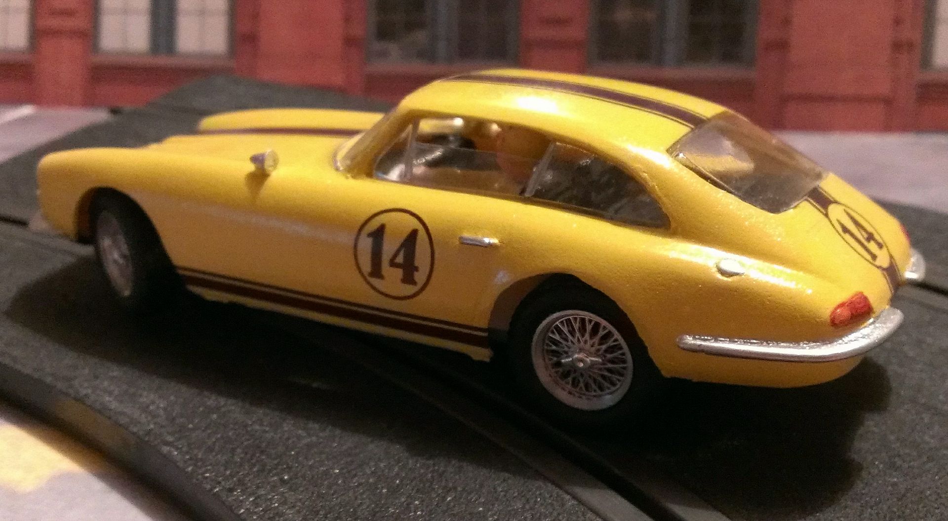

I got the 3D file onto my chassis assembly to check for clearance with the steering mechanism, the bonnet line is very low! Once the file had its surfaces stitched together it was ready for 3D printing to make the master model.
The surface finish is rough so it needed painting, sanding, painting, sanding, painting... until it was good enough for a silicone mould to be taken and resin bodyshells could be produced.
The windows were made up as vacuum forms, the interior from the VW could be reused so the only outstanding issue was the graphics. This took a loooong time to get right, but this morning the waterslide transfers arrived on my doorstep.

What 3D CAD program are you running to create the model, Choc-Ice?
The surfaces look very well done.
Can you break it down in component parts or is it totally solid?

Jules, unfortunately I can't justify the cost of a surfacing program so I get the bodyshell done by an agency, then someone else stitches the surfaces together so it can be converted to a 1.8mm shelled solid. It's all modelled as one part as that's the lowest cost, but once the outer shape is done it could be separated into component pieces.
