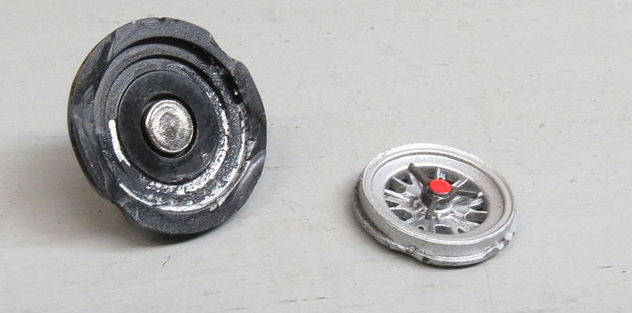

I just thought of something. Long after I had my attempt with the Carrera stubs, I picked up a model train tool, called "The Puller", that just might do the job perfectly. Tomorrow, I'll try it. If it works, I'll post some photos of how I did it.

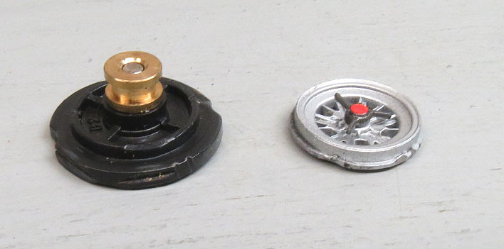

Re: Carrera Stub Axle

by btaylor
That's a great idea Paul! and a lot cheaper in the longrun than using collars. I will be borrowing this idea for sure!
thanks for sharing.

Paul -
That is a slick idea! I will have to add some of those to the "shopping list" for this week's run to Lowe's!
Thanks for the heads up!

Paul,
I think you may have hit on something. Your idea sounds really good.
Having looked at what Harry and others have said my plan is to forget trying to get the wheels off the stubs. Instead I plan to get the nails that Paul mentions and sand them down until they will fit through a brass or plastic bearing and then put the head of the nail on the inside of the bearing, cut the nail to the correct length and press on the Nascar style wheels on the outside.
I will update you guys and let you know how it goes.

by paul gage
look for 10 gauge brass or steel cabinetry nails, measures 2.40 mm OD.
