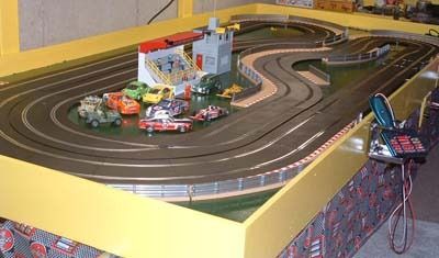

My first table was built by a friend pretty much like you described. The table was for my crawl, so it was built in three pieces, none being wider than 3' to fit in the doorway. He ripped 1/2" plywood into 2" strips and built a frame and covered it with luan top and bottom. The result was lightweight but super strong table. Now the guy who built it had a lot more ability than me and had a 1000 sqft workshop which didn't hurt.
The framework being built
Two sections primed
The finished table
