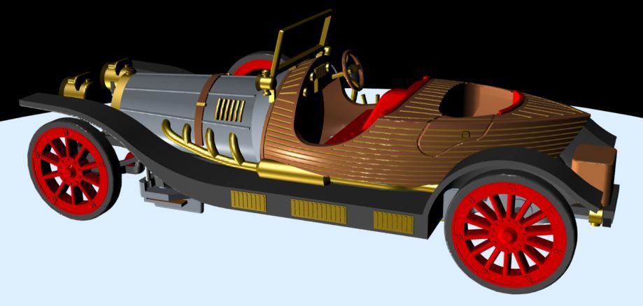

I also found a side photograph of one of the film cars which was a useful check against the drawings. I printed them all onto graph paper so I could take measurements from them and start putting it into the CAD. I wanted something easy first so started with the wheels. There's quite a lot of detail here and getting them right gives any car a head start. The rears have 14 spokes and the front has 10 but there are also clamp bolts that hold the rims together and lots of detail around the hubs. The wheels were specially made for the film, hiding drum brakes inside them so it would look accurate for an Edwardian racer.
Once the wheels are done I created the assembly with them in the right place, adding the motor too so I'd have a sense of where things could go and any limitations in the body. Then I could start with the body shape, beginning with that very Bugatti-like radiator and making a swept blend to the circular shape at the back end of the hood. The fenders are probably a bit too thick for scale but I've gone for what will survive on a slot car track.
The rear bodywork really was made by a boat builder and it's quite a tricky shape to make in a CAD system, especially if you're as unskilled as I am. By this stage it's probably been about 10-12 hours on the CAD and obviously plenty of time in front of that in the planning stage.
There's lots of time spent re-checking bits because you don't know what's wrong until more is finished. However this is at the stage where the outer body shape is quite well defined and I'm making the seat spaces. Then it's the rear fenders and I can start on the detail bits like the windscreen, lights, horn and outside gear lever.
I had decided the car won't have suspension but it will need steering so I needed to sort out how that will work and keep the guide as hidden as possible yet still link up with the steering arms. I toyed with what to do with the wings but decided it's probably one more headache than I need so I left them off, especially as folding them in like the Corgi toy interferes with the motor position.
It's a very large car as you can see.
A bit more work and the seats are done although I hadn't done the buttoned effect on the rear yet, dashboard is done and the bulkheads through the car that means it can be cast are done by this stage too. I had started on the rear fenders but need to tweak them to shape.

A little more detail in place on my car, the screen is sized nicely and the spare wheel in place which needed a recess in the front fender. It's far over enough to allow the boa constrictor horn I hope, but you never know until everything is in the model.
A few more details added, headlights really help!
The lights, windscreen and a few other detail bits will be made separately as they're just too fragile to put with the rest of the bodyshell. I decided to make them as SLS parts so they'd withstand the rigors of track action, when I did the CJ7 Jeep it's windscreen was particularly fragile without brass bar glued behind it.
Extra detail on the headlamps and by now I've got the front axle and hubs worked out. The guide will be quite a long way back to keep it out of sight, just like the Scalextric Bentley and Alfa Romeo. I know this isn't optimal for racing, but from what I remember my old blue Alfa cornered really well (at least compared to the Bentley) so I'm hoping it will work out alright. The guide on the Italian Job coach is on the second axle and that seems to handle in a very forgiving way, especially considering its size which makes Chitty look svelte.
I then spent an frustrating few hours sorting out the motor pod and it's mountings into the resin bodyshell. On the outside I did the numberplates, louvers on the running boards and hood hinges.
And the tail lights
Next I added the steering wheel, gear lever and horn which will be separate parts in the kit. I've also put recesses on the boat where the wooden sections were joined. This was incredibly slow work but hopefully it will help with the final paint job.

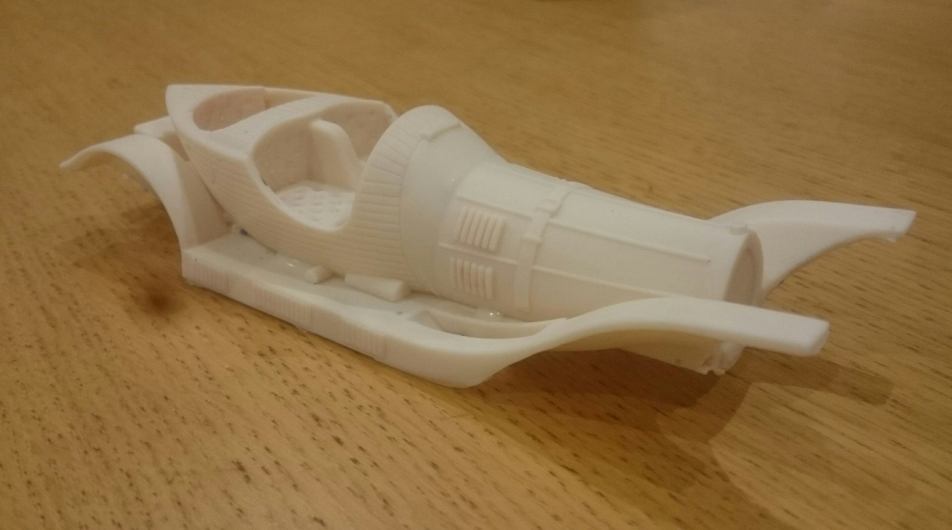

Here's the plan: 3D print the bodyshell, silicone mold and resin cast it. The separate parts will be 3D printed and polished in SLS. How hard can it be?
Here's the 3D printed master, with my 1967 Mini Cooper for size comparison
Mold made, resin cast bodyshell done
Running gear in place
Here's where I decide the tires need to be custom made as the Scalextric Bentley ones are too high profile on the sidewalls and I really want the correct tread pattern and GoodYear lettering.
