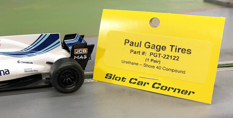

Nice cars. Any suggestions on PGT tire sizes for these cars?
Re: Scalextric F1
PostPosted: Thu Jul 26, 2018 6:32 pm
by HomeRacingWorld

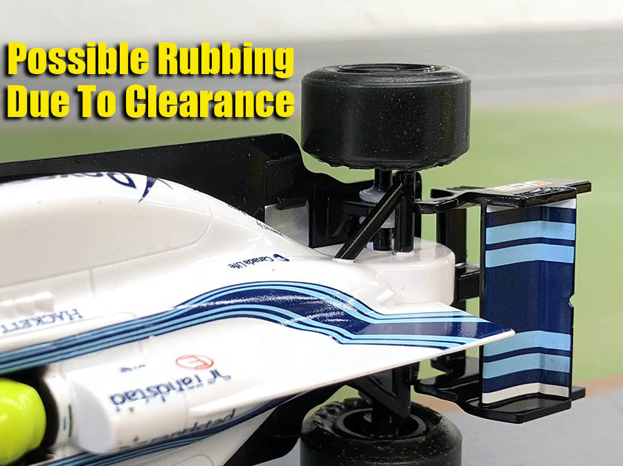

Best fit unless you are willing to sand.
The chassis trailing edge is VERY close to even the stock tires, so trying to go any taller will just rub. These are the best slip-on fit.
Re: Scalextric F1
PostPosted: Thu Jul 26, 2018 9:16 pm
by Slot GT
Perfect. Thanks Harry. :handgestures-thumbup:
