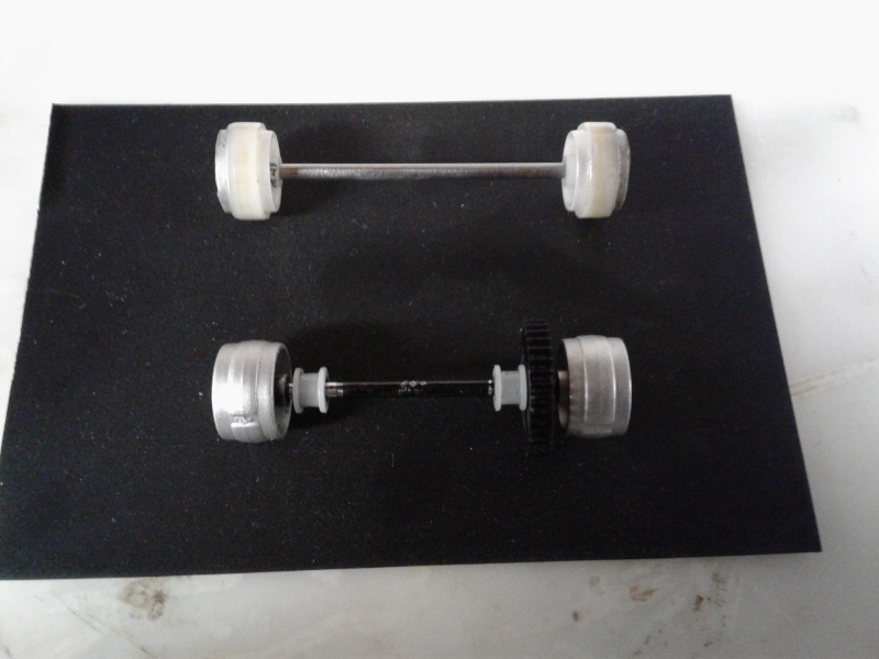

Thank you Harry and Rich for your replies. It now appears that I am dealing with a different design here.
The axle at the top of the pic is the #77 Challenger wheel while the axle at the bottom is the NTVP Challenger.
The crucial difference is the OAD's of the rib and the inner, outer surfaces. The #77 wheel measures 0.484" Inn., 0.490" Out., and 0.575" Rib, while the NTVP wheel measures 0.525" Inn., 0.530" Out., and 0.557" Rib.
Our club rules for Vintage T/A dictate that the wheels must remain stock, so even after truing over 1mm off the tire I will still have a large air pocket under the center of the tire. Oh well I guess I'm going to have to be "creative" :lol:
Thanks again
Randy

The street version of the Challenger use a different wheel than the race version did. The white car and the pink car are different from the green race car that car uses a standard TA wheel size.
Mike

Randy,
The wheels from the pink car measure as follows Rib .55". Inner and outer .52" I took a tire off of a regular TA wheel. It fits on this wheel with no issues. It was probably a 1102 Yellow Dog. May be the 1101 or 1105 because it is closer to 9.3 mm wide. Sorry my Caliper only goes to 2 digits in inches. This tire may fit the new rim as well. There was a thread not sure where about filling the space on a Carrera wheel. The person used a Gel CA glue and then sanded the spot as required.

Thanks Arrold. Your wheel is Identical to mine. I'll check out the 1101 and the 1105 as I really did not like the poor fit of the 1102R that I tried using.

Masking tape wrapped around the hub and trimmed to the width of the rib will build them up without changing the 'stock' wheels, and if complete revolutions without overlapping are done they're pretty round. It's worked for me in the past.
