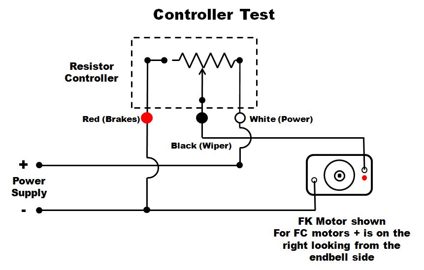

There is a neat little test that you can do with your controllers.
I have a bench power supply that I use for all my motor break-ins and testing prior to heading off to a race. I find it so much better to have tested the direction the car will go on the track PRIOR to going to the track and finding that little WHOOPS that grabs us from time to time.
Just take the POSITIVE terminal of your power supply and connect it to the WHITE alligator clip on your controller.
Next take the BLACK alligator clip on your controller and connect it to the POSITIVE (red) motor connector.
Finally connect the NEGATIVE terminal of your power supply to the NEGATIVE motor connector.
You should now be able to control the speed of your motor.
If you want brakes, just hook up the RED alligator clip of your controller to the NEGATIVE motor connector or NEGATIVE terminal of the power supply.
Sorry but my CAD program is not up at this time or I would draw up a little schematic for y'all. RichD, can you do that for me?

Postby RichD » Tue Jan 21, 2014 9:04 am
How is this? I think I got it right, I will send you my bill.
