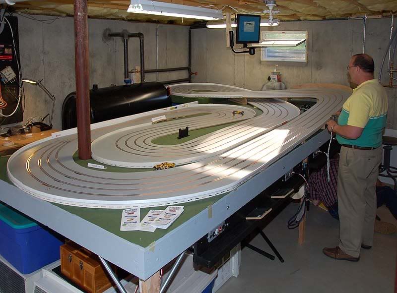

I see no advantage to using a plunge router. Be sure to us a high quality carbide bit like the one that Slot Car Corner sells. If your track is well designed you will be less likely to get bored with it. Tracks with elevation changes are more interesting than flat tracks. It would be a good idea to do a full sized mockup of your track design with craft paper or cardboard. You could design your track to make it easier to change later on. Braided tracks are easier to change than taped tracks.
This track had to be changed to fit into a new space.

The tracks look great !!!!
Especially the Ferris Wheel !! LOL
