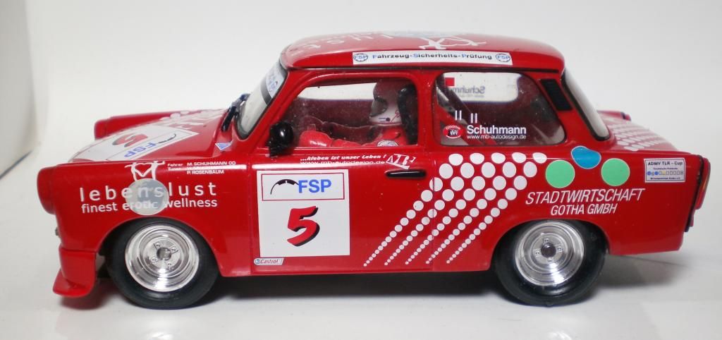

IMHO Revell/Monogram often use tires that are the bare minimum diameter to fit under the body work. The Cortina front ends drags a little and tri-pods in corners as a result. I make re-pops for them, however I use and strongly advise using the SCX Escort MkII tire re-pops (listing #150523996866). Perefect fit on the wheel, extra 1mm OD, and just a little sanding on the outer sidewall to clear the fenders.... great running cars with the Scaley and Carrera Grp2/U2 cars...
If you can't resist adding alloy wheels, the new CB Design 14x6 Steelies will clear everything, shown here on my R/M Trabant with PGT-20084 tires...
