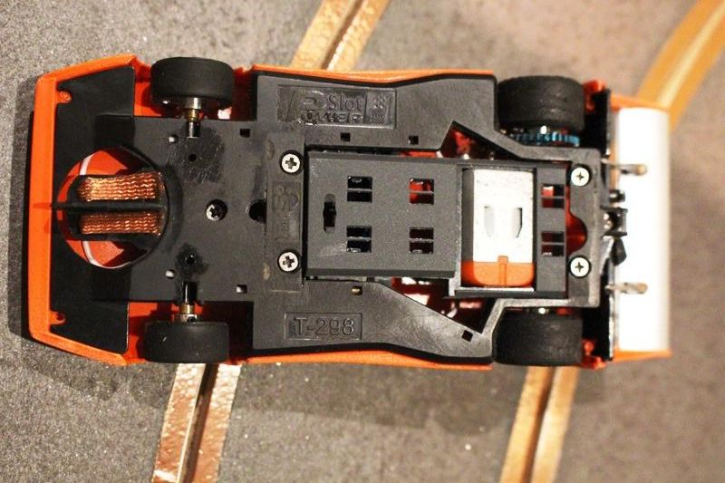

OK, I put a set of PG tires on the back, adjusted the gear mesh with a spacer, trimmed the braids and adjusted the front axle height. The front is set up with two grub screws above and below the axle which is something I didn't expect. It ran smoothly but the motor is rather anemic, probably rated at or below 18k rpm and it has little braking ability. So, as well as getting a set of slot.it hubs I will probably be getting a better motor too.

After letting the motor run on the test stand for about 20 min @ 8v it seems to be much more lively and the brakes are better. I went to the Power slot web site that is still up and discovered that the motor can be moved forward or back to adjust the gear mesh. With that in mind the screws make sense.

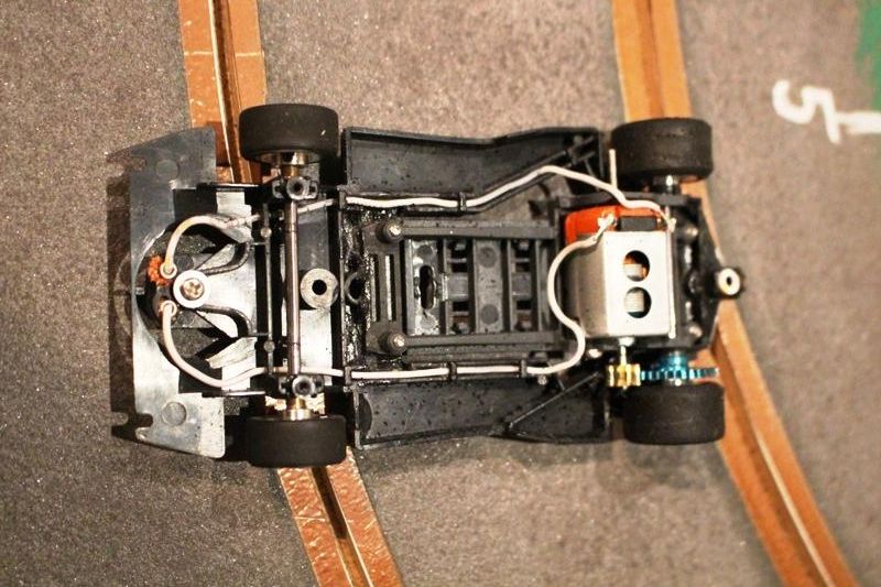

Here's what I did to mine recently. basically our classic sports car class requires Slot It 21500 and NSR 20K FC-130 motors.So I grafted a slot it pod into the original powerslot chassis.

Postby Nor Cal Mike » Sun Nov 30, 2014 7:44 am
Now that is a nice looking set up.
