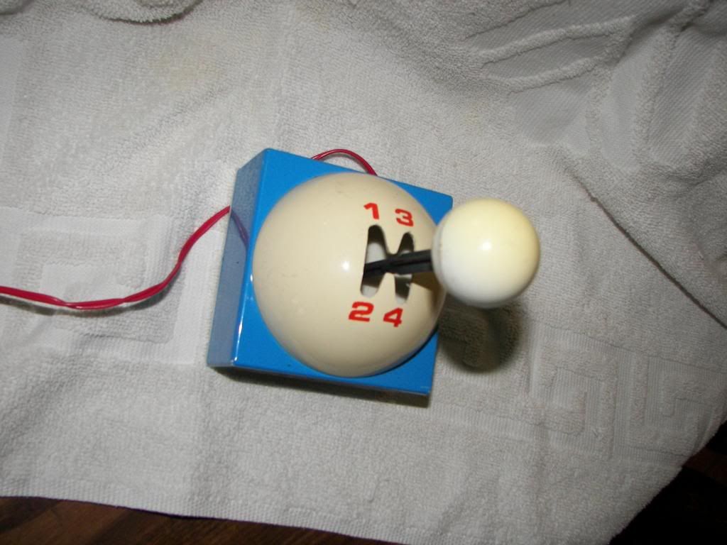

Postby pfuetze » Wed Jul 23, 2014 12:50 am
http://i214.photobucket.com/albums/cc43 ... 000ab6.jpg
the dragstrip will only be mobile, not installed permanently, no room for setting it up all the time here, too.
found shifter controller on the bay, thanks to 007, but i think i need to rewire them. will report when they arrive :)
