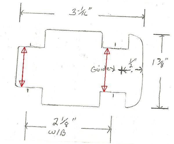

Peter, is there anything in your line up that may fit this layout ?

Postby Derby City Speedway » Mon Jul 15, 2013 1:30 pm
466"x.250"x.094" R/D
466"x.312"x.094" R/D
Rear measurement is 1"
Front measurement is 1-1/16"
Braid type guide

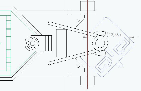

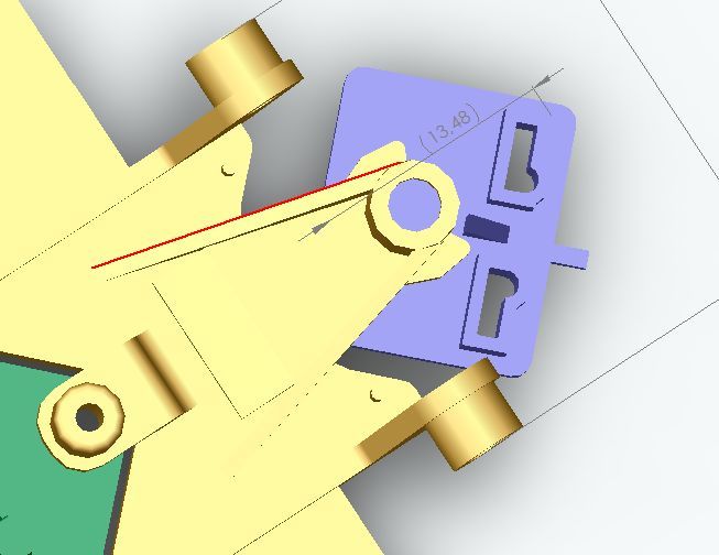

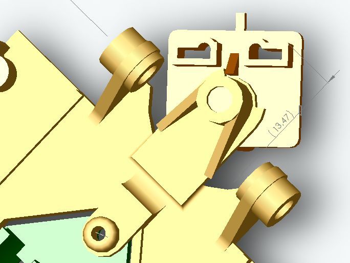

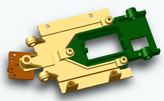

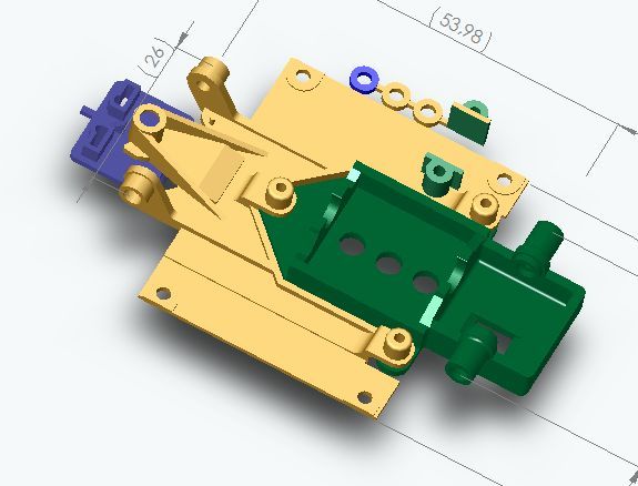

Postby pfuetze » Tue Jul 16, 2013 12:45 am
Mark, on the front, the guide will protude in fully pivoted position by app. 1mm (1/2" = 12,7mm), but this is measured from the plain of the middle of the front axle and your measurement with the 1/2" is starting from the guide stem middle.
what measurement did you guess from the middle of the front axle to the middle of the guide stem?
here are 2 pictures of the chassis right now, i think it should be possible to stay within your specs :)
the chassis are already on shapeways with your measurements.

question, are we close to the 3-1/16 " from rear chassis to front of braid guide?

It's for a 917 pink pig Peter, it's a diecast right now. But if I can make all this work, I plan on casting it. I'll order a couple of each tomorrow after I get up. They look super thanks again.?

Mark, i was wondering about the dimensions. But pink pig is the explanation :D
