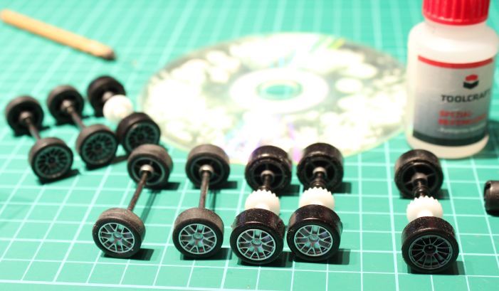

sounds like a great programm for a rainy friday!
after a long work week, i maybe start glueing some tires to rims, as i got a delivery of tires yesterday. New shoes for the Astons ...

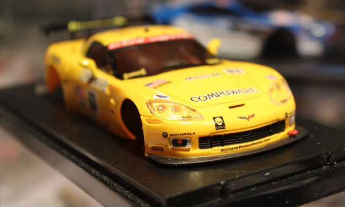

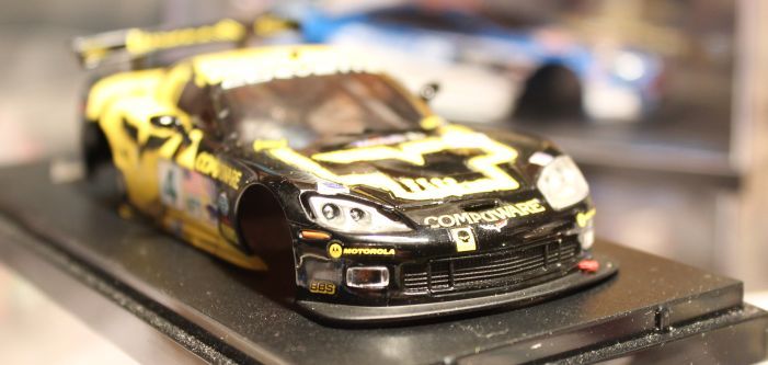

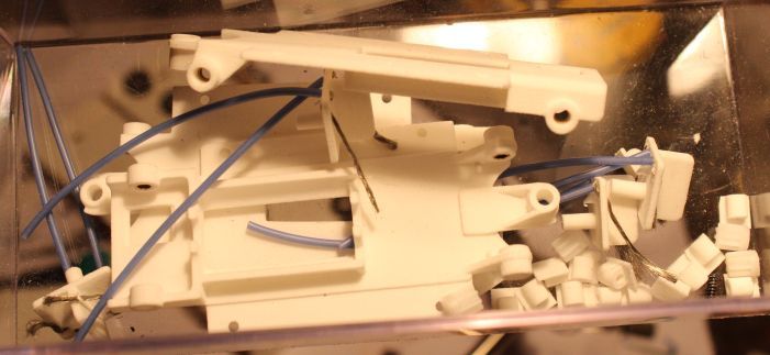

Finally some time to work on the DSlots ....
Both Corvette had a nose issue - on the yellow Vette, the front lip was raised by 2.5mm, but only on the left side. Tried to heat the body under flowing hot water, but that did work. Got out the old hair dryer - heat stage 2, air stage 1, directed directly to front, from the inside. Waited half a minute and carefully bent it in the opposite direction of the warp. As you can see from the pictures, it´s better now. Only app. 0.3mm are left. I can live with that. Also cutted 16 pieces of brass tubes to be used as bearings for the chassis. And the big tire glueing has started, too. Got the last CarGo tires on thursday for Aston, they fit great, thanks Carsten!
Really looking forward to race these DSlots!
What is the finest point of the Dslots, by the way? The details, right! What is not so fine about details? They can be lost! After bending the front, i did not recognize immediately that i lost the headlight cover of the black vette. But i did 10 minutes later ....
And after another 7 minutes on knees, i finally managed it to find it again, feeling really lucky :D strange, ey?
