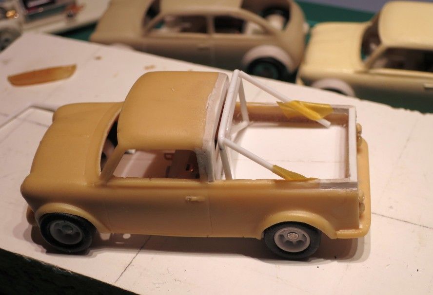

Postby pfuetze » Wed Oct 26, 2016 1:00 pm
​Image​
Image​
Image​
building the roll cage - not my favourite work, i have to say ...

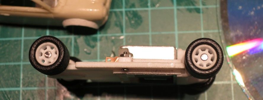

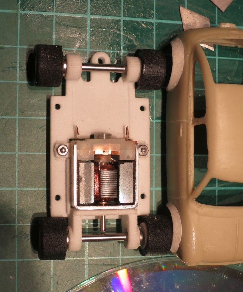

new Mini chassis with ball bearings and new type of tyres with rounded sidewall :D

That looks like it will be very fast. Those tires look very familiar to me. I may have used the same master to cast mine. I am sending along 10 pairs for prizes in your Proxy.

Postby pfuetze » Thu Oct 27, 2016 12:22 am
the masters for these tires have been printed in frosted ultra detail material by shapeways. CarGo casted these tires for me (and i think will make them available for everyone who is asking). I like the look way better the old ones which where casted from Marchon Jeep H0 wheels with flat sidewalls.
The Mini is not that fast, i´m still searching for the best motor/gearing combination.
The ball bearings and the 2.38mm axles hopefully will make changing gears a little easier. Still, i will have to drill out H0 gears, due to size, the Mini wheels are 11mm
