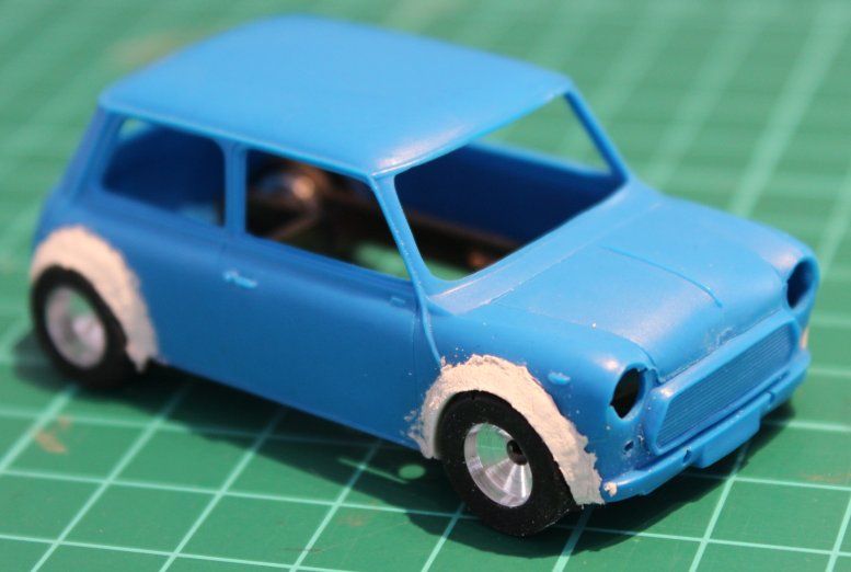

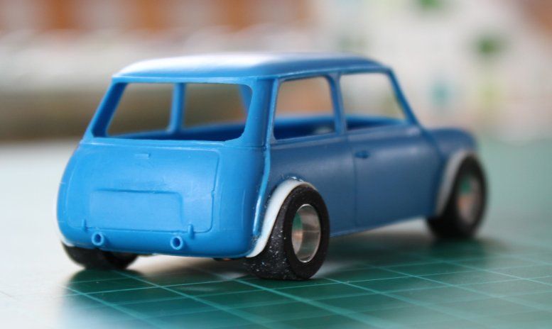

opened the wheel well a little (hard to get even), glueing some pre-formed styrene into the wheel wells (quite easy), than cutting the styrene widener into shape (not nice) and now adding putty - i don´t like it! i hope that i´ll like the end result LOL

Nice stuff guys. What putty are you using Peter? I have gone to using some putty called Green Stuff. The guys who sculpt "miniatures" use it. It is a two part epoxy putty, One yellow strip and one blue strip that you mix together (one to one) to make a... Wait For It... green stuff. Works and sticks like a hot damn. Smooths out with dental tools and Vaseline jelly coated tools, cures over nite and sands/ machines well after curing. I'm using it to sculpt my Dragon!!! (and fix my cars.)

i´m using just revell putty, called "plasto". one compound out of a tube. sands nicely so. made nice progress, already had the 2nd go with the putty to smooth out the holes left after the first try. had to get some finer grit sandpaper but 240, 280 and 600 seem to do the trick. more tomorrow :)
