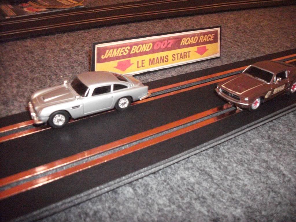

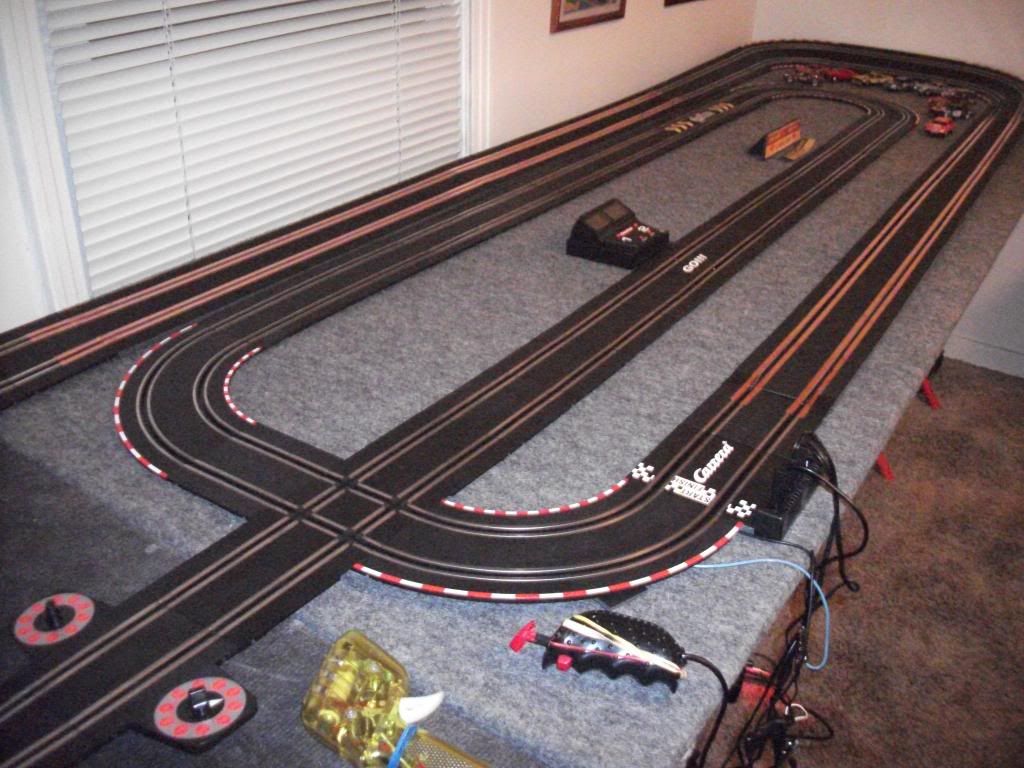

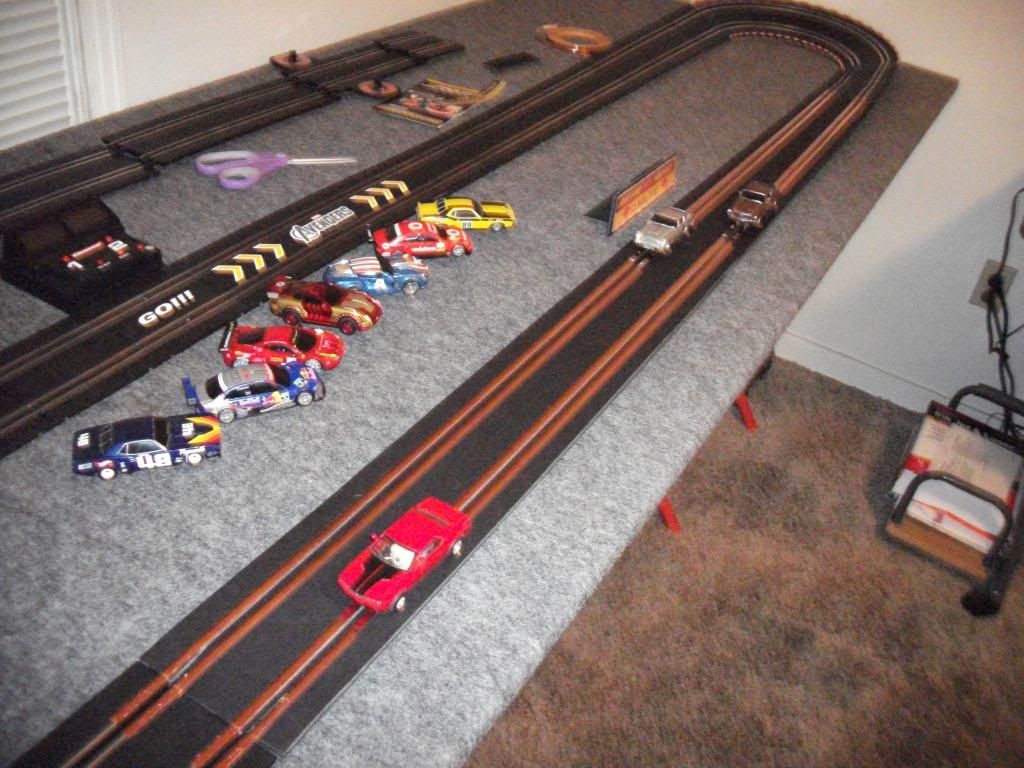

I have been playing around with the GO track that we have.As always ,needed more straights.Seems that way which ever scale it is.Thought about some foam board.Cheap, easy to cut since I only needed straights.Slapped these together in a short time.Guys it works great,just make sure your lane spacing is correct.Copper tape and we were racing.

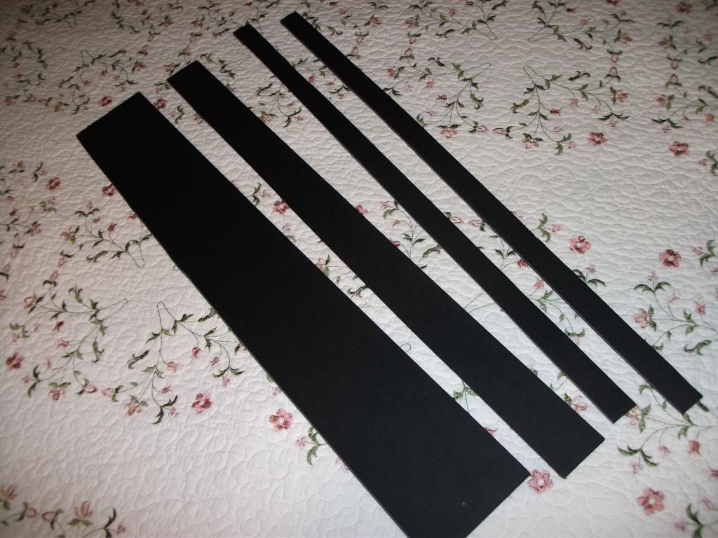

I made a foam board track several years ago out of the type of foam that you cover a house with.It had a foil covering ,which we painted,and we ran the fool out it.
On this deal I just glued the foam pieces onto the same type of foam board with tackey glue.I'll try to get some pictures of the next section before I glue them together..

Hey thanks guys.I just used black foam board,no paint.Here are a couple of pictures of the before and after.Just cut the top pieces to size.Gained about an extra 10 feet of running from two foam boards.
