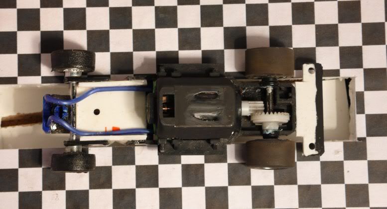

I have the solution for you with an Artin chassis and will publish pictures when I return home. Or maybe Tom Ward (Nerfbarz) will see this and publish a pic or two. He came up with this system. Cheap and simple.

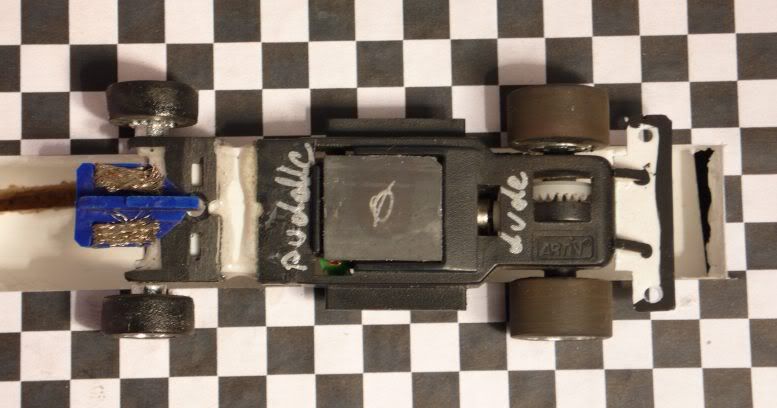

Postby pfuetze » Mon Sep 08, 2014 12:04 am
Artin chassis are easy to work with and especially to adapt the wheel base. one cut in the chassis on the front end, 3 pieces of polystyrol and glue, you don´t need more. will post a pic later ...

Postby pfuetze » Tue Sep 09, 2014 12:22 pm
Basically, you cut the front half of the artin chassis and add 3 pieces of styrene, one for bottom and 2 on the side. Fix them with 2K epoxy and you´re done. Normally i fix them on one side first and let the dry. After that i glue the front half. The dimension is like a little press fit, in that way it´s easier to get the wheel base right.

Postby Cjent » Tue Sep 09, 2014 2:35 pm
Here is the link to what I use to lengthen Artin chassis wheelbase:
5th Tip down the list!
viewtopic.php?f=6&t=380

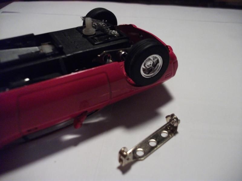

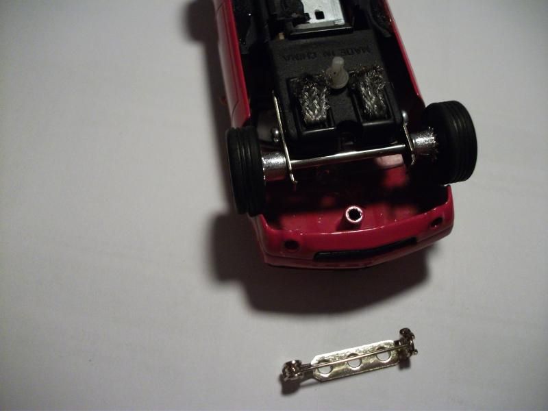

Postby ourwayband » Sat Sep 13, 2014 5:22 am
Here is another option for stretching a chassis.We use the pins that one would buy at Walmart type stores .They are in the craft dept.Used for name tags and such.Work great and you can cut them down to size.
