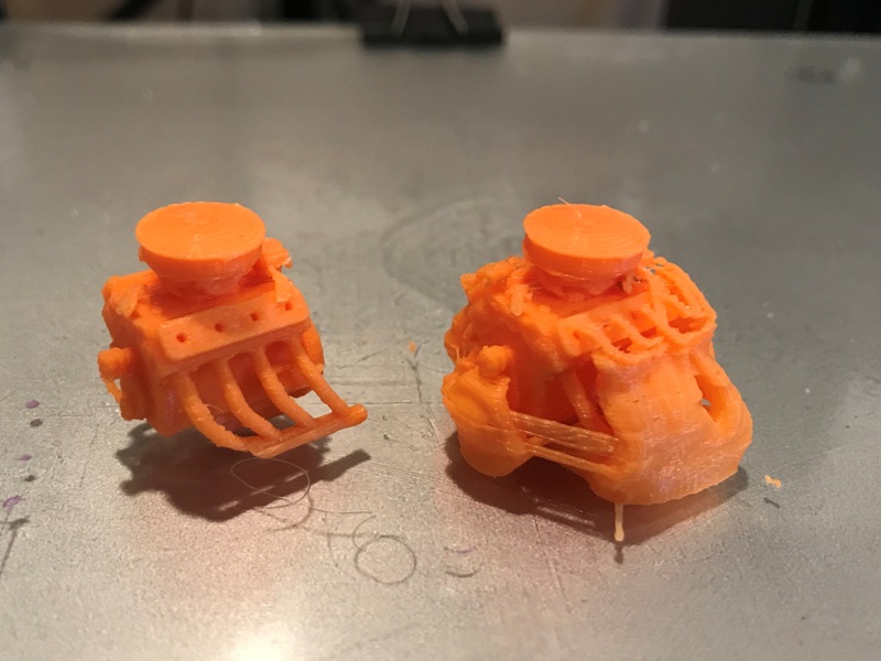

I might be late to the game on this one, but if you haven't tried tree supports over regular supports, give them a try. I have typically avoided anything that needed a support due to prior bad luck with trying to separate the print from the supports. I have been playing around with tree supports and they work so much better.
I printed this motor with tree supports and the detail of the exhaust comes out great.
The one on the right is with the supports, the one on the left has the supports removed. Great motor for a modify build.
