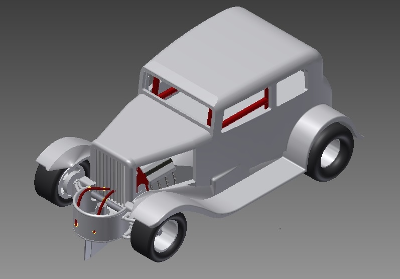

You mean something like these or would I have to detune them.
This is just a standard 31 Ford Vickie with a 4.6 DOHC modeled in with an interior and uses the piranha sidewider with the wide meats to harness that power.

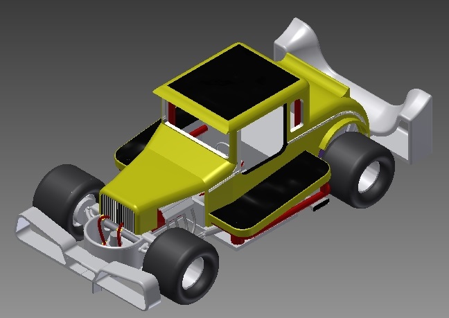

This is my 32 Ford Model A where I got a little carried away by adding some Indy downforce but still modeled up a 4.6 DOHC under the hood and the same sidewinder setup as the Vickie with the same big meats. I could blame the Boss here at HRW for he was the one that got me started in utilizing those wheels and tires, but I won't for his mention of these tires has really added fun in these cars when not using magnets.
