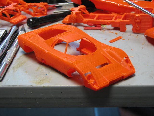

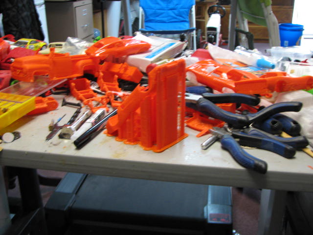

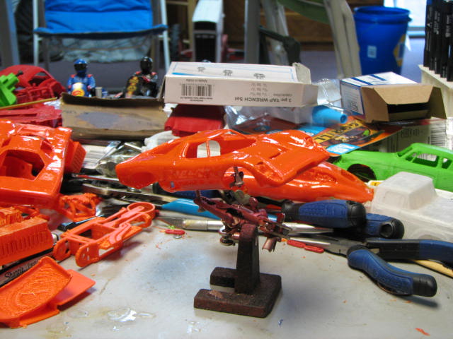

Postby ccobra » Mon Feb 04, 2019 2:37 pm
Some of the challenges that I've discovered is trying to print the body, clean it up, and assemble. This is what I've found to work sometimes. Using a familiar body I printed out three times before I was able to clean out the support material without needed to reconstruct. What I ended up with was to print the body upside down and at a 45 degree angle (315 or -135 degrees on CURA).

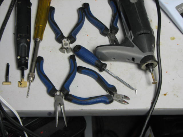

It wasn't a perfect cleanup for I broke off the wiper blade which I'll have to fix later. Anyway I used the dremel with the cutter blade and wheel, duck bill pliers, needle nose pliers, end cutters, and an o-ring pick.
After sanding down the body a little, out came the XTC-3D epoxy and used 6 grams to the body and now after it cures I'll sand it down and fill in the holes.

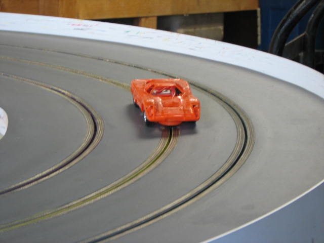

Postby ccobra » Sat Feb 09, 2019 6:45 pm
Finished printing up and assembly a chassis and installed into the body so just had to try it out on the track.
and after a few laps it turned in a 7.882 and then I got a best of 7.113 after 37 laps. not bad for a printed car.
But then I looked at the other 1/32 scale cars and found a small problem. When I set up the body, I just did and overall scale to get the length scaled up to the 162 in overall length but didn't notice the overall width was over by a 1/2 inch for the scale which needed to come in at 2.25 inches to be to scale. Oh well, sure did handle great with the extra width. And since I started it for the extra width, I might as well finish it.
