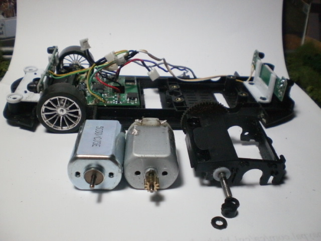

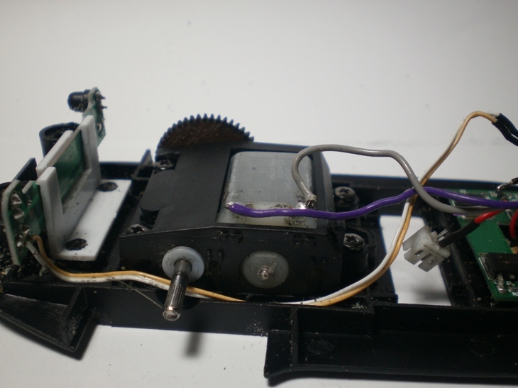

Not quite sure how much detail is needed for this conversion. It is simply put "swap the pinion, transfer the wiring, drop the motor cover on top of the new motor, torque the screws, connect the wires, quick test, install the body" and then go kill some Scaleauto 997's! Okay, there can certainly be more, but that is a good starting point. In the pics below you can see the chassis stripped down, the old and the new motors side by side, and the empty motor housing. I just place the motor in the bottom of the chassis and drop the cover into place. The cover holds the motor securely in place and the gear lash has been perfect on every installation so far (997, C6R, F575, 2 x BTM Cheetahs, and a GT-40). I order my motors from "AutoArt Collections" website and they are delivered from a California address, the web address is listed on this topic already.
