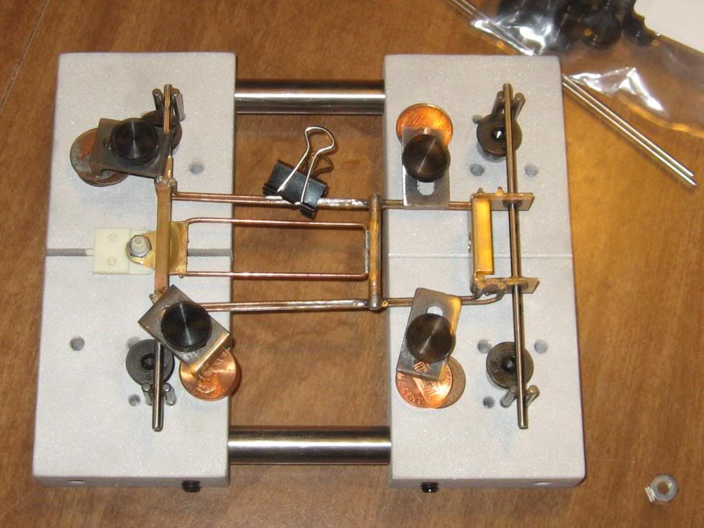

Postby RazorJon » Sat Feb 16, 2013 5:50 pm
here you go, Tom made this using my jig
Re: Looking for some ideas on brass scratchbuilt chassis :)
Postby HomeRacingWorld » Sat Feb 16, 2013 10:03 pm
Must be a need for 4 motors somewhere...lol, not for me. Now MG...all that scale talk on the spoiler for the Charger and you show a chassis with Little Debbie donuts instead of wheels? geeeeez :) Just kidding with you of course.
