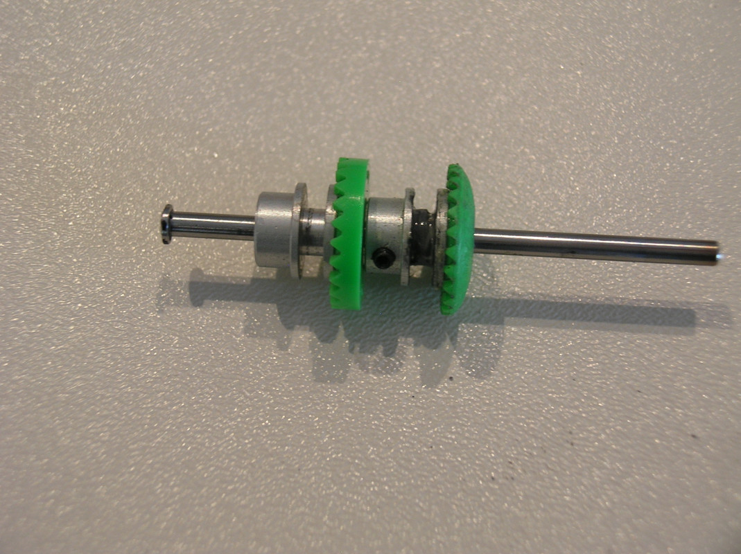

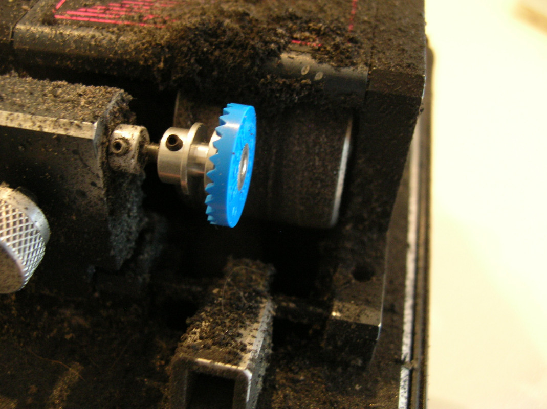

Step one....mount a Slot-it Crown on a tire truer, (any tire truer works), or on an axle, and in an electric drill. Installing it with the "hard edge" out gives you more room for the next steps. (see pics.)
On a Hudy
On an axle, mounted in an electric/cordless drill/dremel

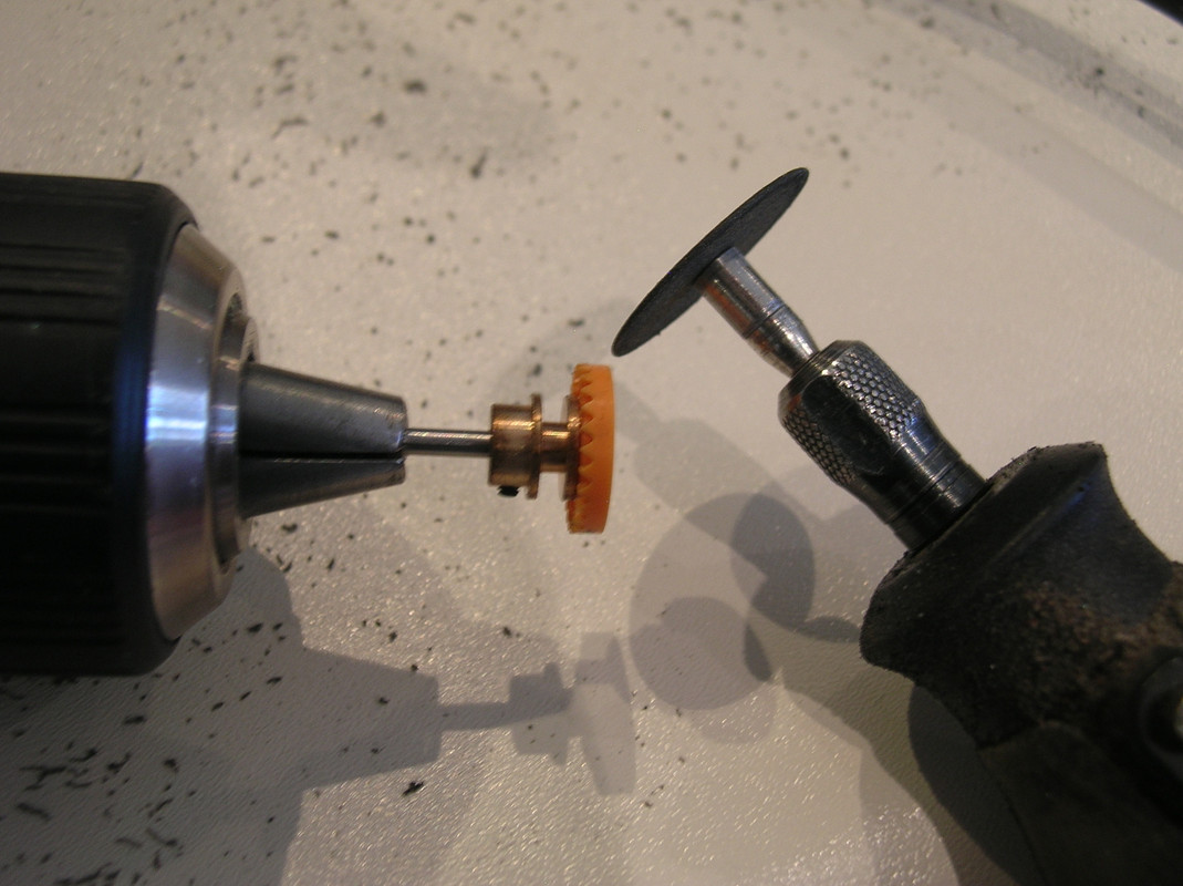

With both the tire truer/drill powered, radius the rear edge of the Crown with an emery board, sandpaper, or dremel/cut off disc (I prefer the dremel route, but the less adventurous among you may prefer the less intrusive options ;)
If using a dremel/cut off disc, you find it easier to cut at a 90 degree angle to the crown.
This is not the best pic. showing the 90 degree angle of attack but, it does show how you want to profile the back edge of the Crown.....
