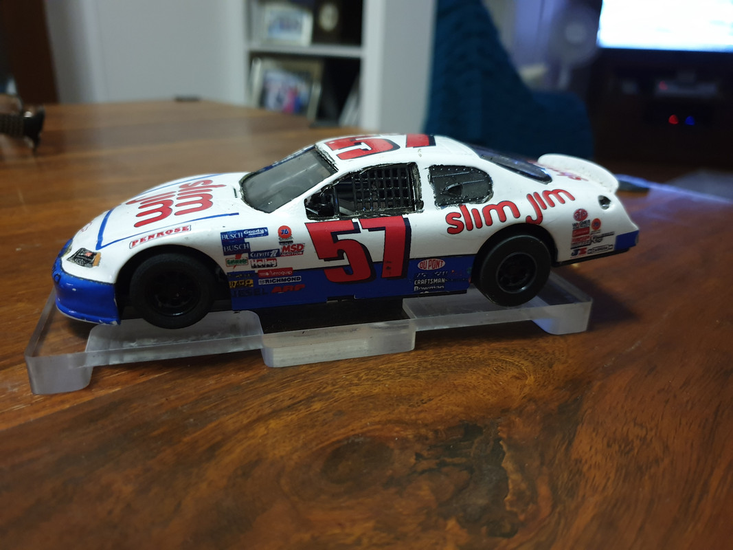

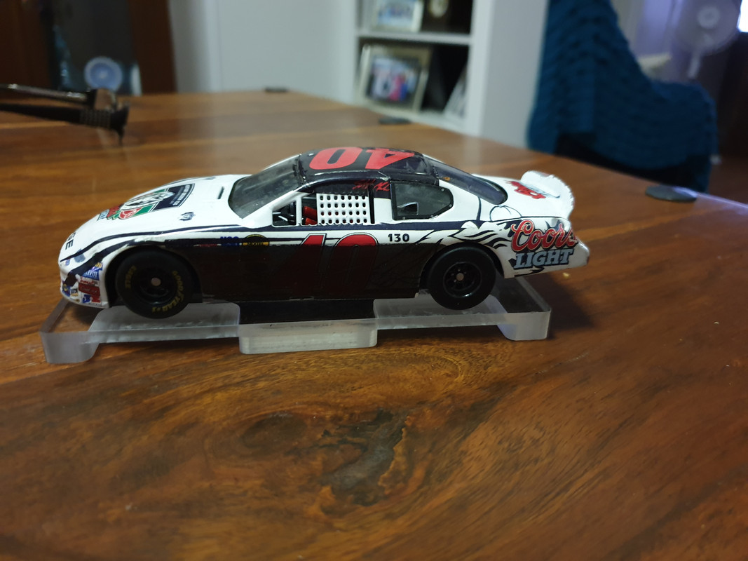

PostPosted: Mon Apr 15, 2019 2:55 am
by Pepsi62
my 2 COY entries

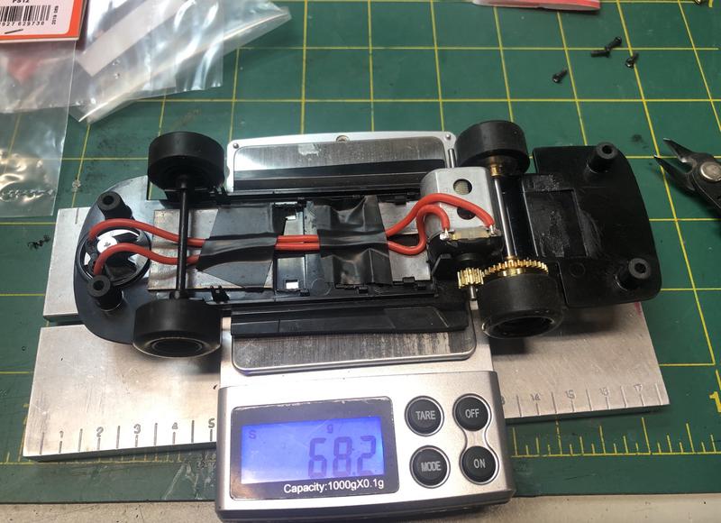

Well I thought I was sending in my #31 COT entry this week until I ran into a potential gear catastrophe. Turns out While it works to use a slot it 11 tooth gear with the stock Scalextric sidewinder rear axle setup ,there is too much play and a good chance to strip the gear.
Ordered new slot it gears late last night, so now I have to go with the CB Design wheels and proper Super tires. Glad I caught when I did or that would have been embarrassing. :oops:
Re: 2019 Build Thread
PostPosted: Wed Apr 24, 2019 10:56 am
by Z-carfan
OK, car is off to the race. :D
Some last minute gear changes, which was more involved than I expected but I think it will run.
Slotting Plus Guide, Slot it gearing 12/35 (yeah I'm trying something different for me)
CB Design rear wheels and Super Tires for rear.
She is a little overweight, but I think it'll stay planted. Fingers crossed for mid pack ad best. :)
