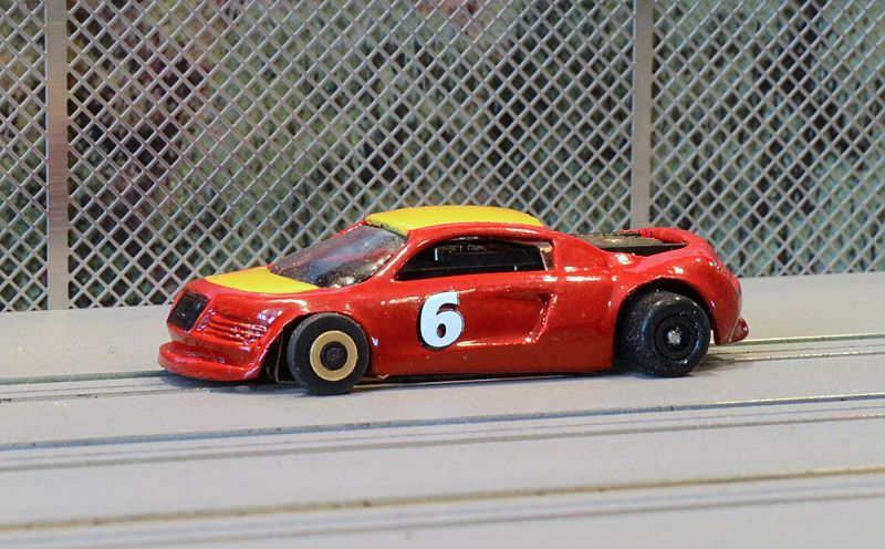

Postby RichD » Sat Mar 01, 2014 12:53 pm
I thought that it would be nice if the T-Dash SS car that I built had its own body so I painted up this 9 Finger Hobbies Audi R8.
